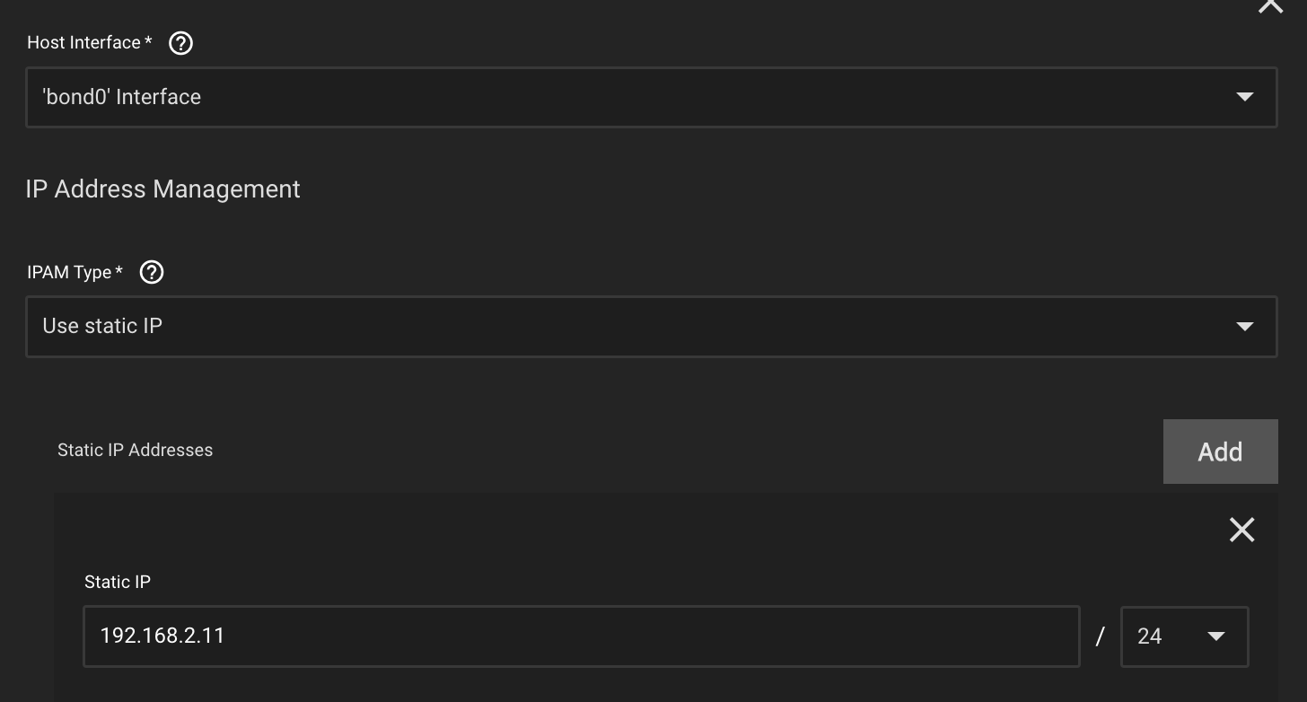

I have a container where I have configured an External Interface with its own IP as illustrated below.
The Truenas Scale system itself has IP's configured on bond0 as well.
The container is reachable from the rest of the subnet, but not from the Truenas host itself.

I have run tcpdump from both the host and the container, and all I see is an arp going out, but the other side does not receive it.

You need a bridge in front of that bond if you want the host to be able to communicate properly with it.

Thanks. That did the trick!
