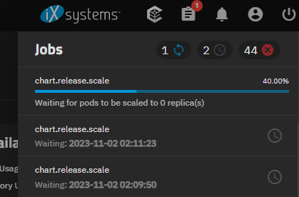

2023-11-02 02:09:08Deleting load balancer
2023-11-02 02:09:08Deleted LoadBalancer DaemonSet kube-system/svclb-nextcloud-90c4db4d
2023-11-02 02:09:08Deleted load balancer
2023-11-02 02:09:08Scaled down replica set nextcloud-cnpg-main-rw-85858f45b5 to 0 from 2
2023-11-02 02:09:08Deleted pod: nextcloud-cnpg-main-rw-85858f45b5-xcx7r
2023-11-02 02:09:08Stopping container pgbouncer
2023-11-02 02:09:08Deleted pod: nextcloud-cnpg-main-rw-85858f45b5-79qfh
2023-11-02 02:09:08Scaled down replica set nextcloud-imaginary-6f89889dfb to 0 from 1
2023-11-02 02:09:08Deleted pod: nextcloud-imaginary-6f89889dfb-4bvzh
2023-11-02 02:09:08Stopping container nextcloud
2023-11-02 02:09:08Scaled down replica set nextcloud-64d7f87b6c to 0 from 1
2023-11-02 02:09:08Deleted pod: nextcloud-64d7f87b6c-xzdb9
2023-11-02 02:09:08Scaled down replica set nextcloud-nginx-6c4fcd6bfc to 0 from 1
2023-11-02 02:09:08Deleted pod: nextcloud-nginx-6c4fcd6bfc-5vwqm
2023-11-02 02:09:08Scaled down replica set nextcloud-notify-6d695b4c5 to 0 from 1
2023-11-02 02:09:08Deleted pod: nextcloud-notify-6d695b4c5-phsst
2023-11-02 02:09:08delete Pod nextcloud-redis-0 in StatefulSet nextcloud-redis successful
2023-11-02 02:09:08Stopping container nextcloud-redis
2023-11-02 02:06:17Job completed
2023-11-02 02:06:17Saw completed job: nextcloud-nextcloud-cron-28314785, status: Complete
2023-11-02 02:05:55Startup probe failed: dial tcp 172.16.0.192:7867: connect: connection refused
2023-11-02 02:05:45Created container nextcloud
2023-11-02 02:05:45Started container nextcloud

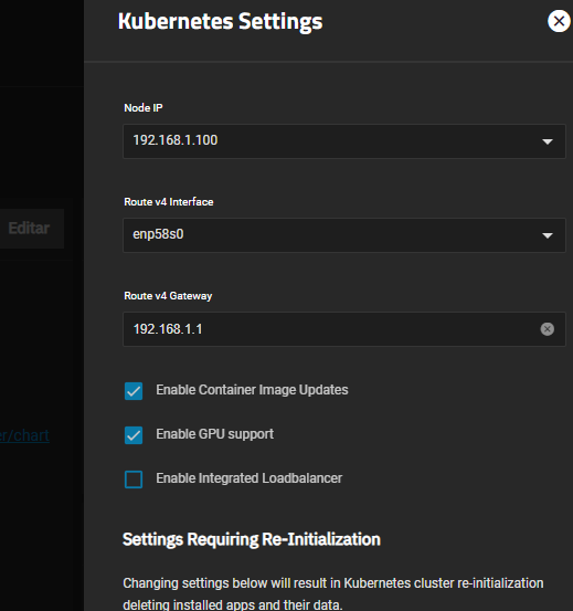

Does disabling the load balancer seem to fix the problem?
it starts but has no access

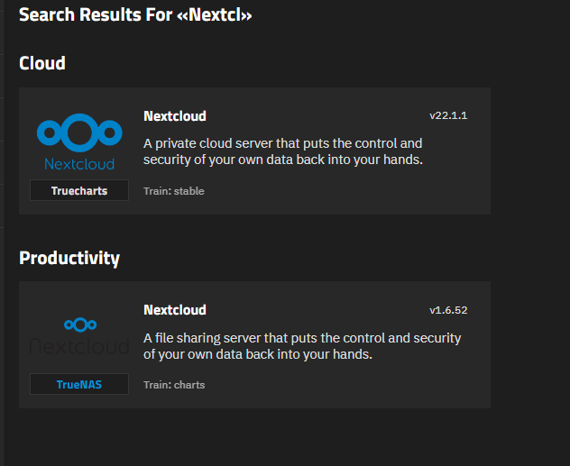

Is this the TrueNAS version of NextCloud or TrueCharts?
If its the TrueNAS official version, please open an issue upon our github repo and we'll take a look:
Isma
Apr 29, 2020
100
the two official versions that the apps show me
It always stays at this point, whether to update or turn it off or on.
I also have problems with access on port 80
I checked it, I thought it was my router sending me to my router configuration page, but when I installed seafile instead and tested, it accessed port 80 correctly, redirecting its port 13080
So nextcloud in my case has a problem with access, port, startup, and app configuration
LarsR
Oct 23, 2020
719
Truecharts is not an official version made by iX. It's a third party app catalogue with a seperate developement and support channel.
If you've installed the truecharts version you'd have to file a support ticket on their Discord. See www.truecharts.org
