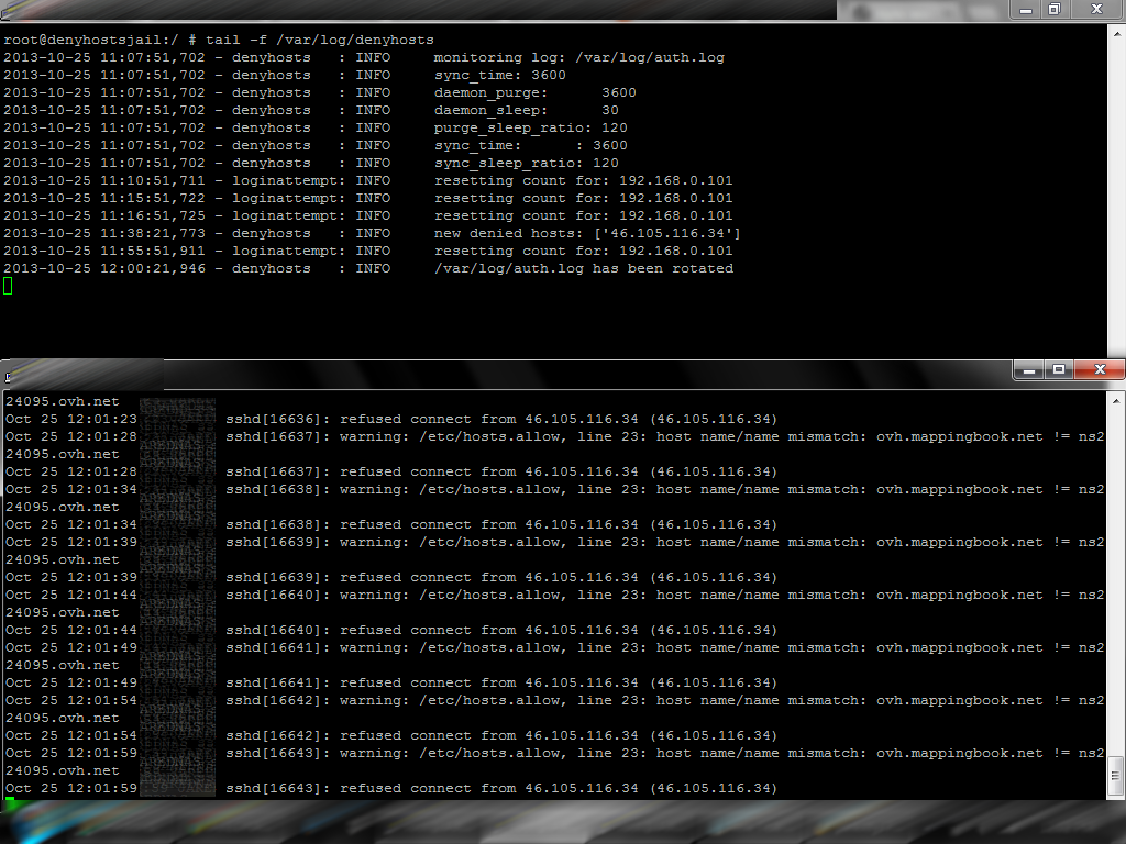

Here is a screenshot..

So are you routing all traffic through the jail/denyhost?
Yatti420
Aug 12, 2012
1,437
No.. All traffic remains as is.. The auth.log (from freenas usb) is sent to the jail where denyhosts reads it.. If it detects too many requests etc it adds (freebsd compatible) sshd : host : deny in a Hosts.evil file.. I mounted my freenas usb in order to edit the hosts.allow (usb install) so sshd will check this Hosts.evil (within the jail) first before allowing the connection through.. I also changed the sshd base config so I don't have to manually do this in the future..
Any jail with SSH enabled can be setup to check this file aswell.. I tested DenyHosts sync feature.. Very nice.. Brings in the top nasty hosts based on other users syncing and the database kept here(Disabled Currently 2011 Date)..Seems to work great as I'm watching the logs currently.. I believe the page is down but updates are still working as intended and should be current..
Edit:Confirmed it's functioning as intended.. http://forums.freenas.org/index.php?threads/install-denyhosts-within-a-freenas-jail.15906/
