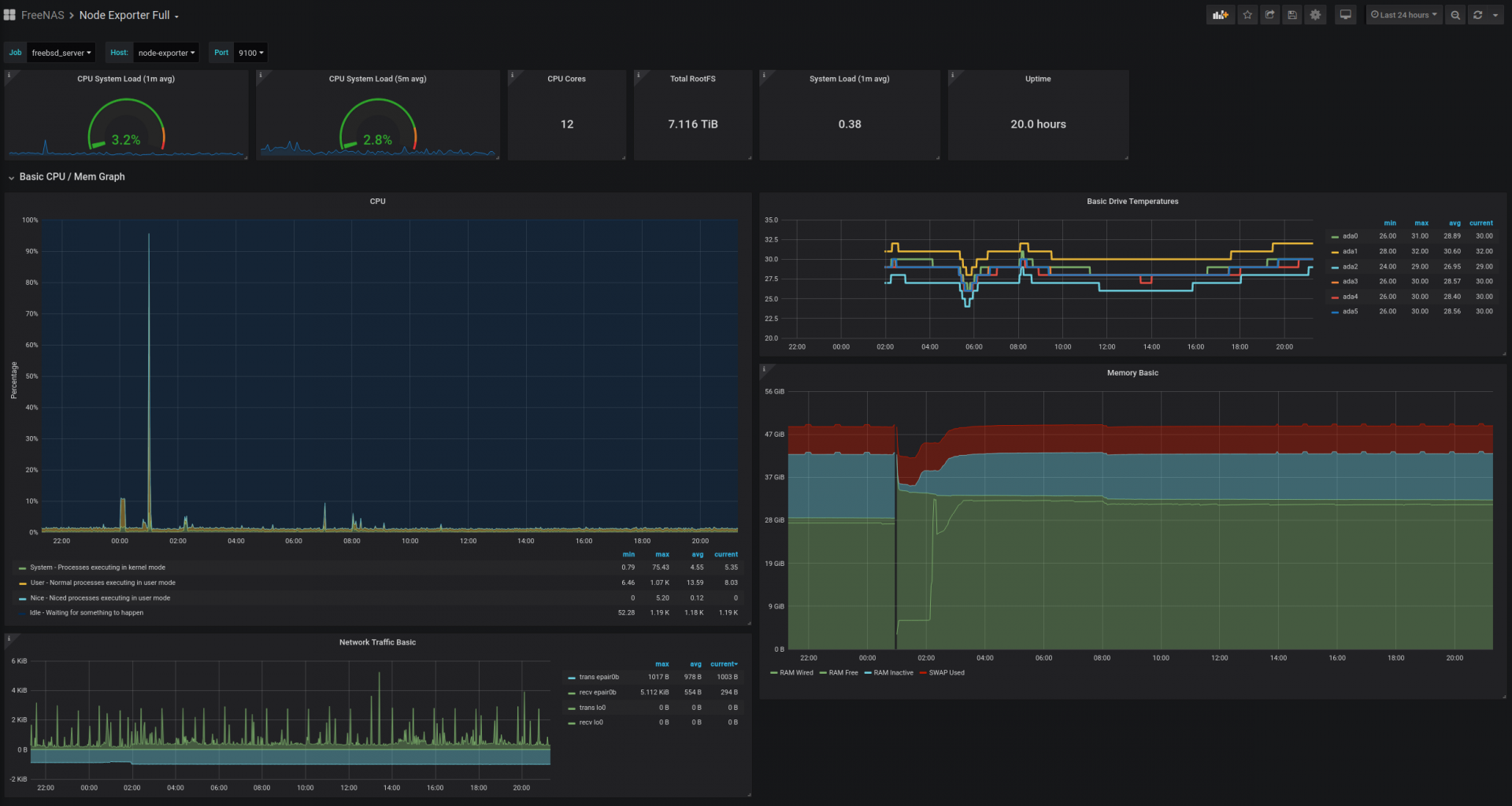

The only thing I -don't- use the server for is monitoring metrics, because if something happens to the server, then I can't view the metrics... So I put Prometheus and Grafana on a fresh install of raspbian, on my pi4. Now I feed it metrics from node_exporter and my minecraft instances:
Node Exporter exports a fair bit of metrics, so I'm still figuring out dashboard items in grafana.

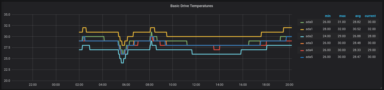

I haven't had any real issues with using AMD other than not being able to see disk temperatures with smartctl. I can see them in the GUI, but I needed a way to get those programmatically within a jail. So I wrote this script:
I run it every 15 seconds with a staggered crontab:
When I feed it into Grafana from Prometheus, it looks like so:
Pretty nice, if I do say so myself.
#!/bin/bash # sets our output file and clears it outfile=/root/temps/disk_temps.txt echo '' > $outfile # grabs our disk drives and cuts out nvd because # it doesn't show temperature when queried drives=$(sysctl kern.disks | sed 's/kern.disks: //' | sed 's/nvd0//') # iterates over each drive (ada0, ada1, etc) and # -appends- the output to our target file for drive in $drives; do temp=$(smartctl -A -i -v 7,hex48 /dev/$drive | grep Temperature | awk '{print $10}') echo "freebsd_hdd_temp{drive=\"$drive\"} $temp" >> $outfile done # sample output: # freebsd_hdd_temp{drive="ada5"} 30 # freebsd_hdd_temp{drive="ada4"} 30 # freebsd_hdd_temp{drive="ada3"} 30 # freebsd_hdd_temp{drive="ada2"} 28 # freebsd_hdd_temp{drive="ada1"} 32 # freebsd_hdd_temp{drive="ada0"} 30
* * * * * bash /root/temps/disk_temps.sh >> /var/log/temps.log 2>&1 * * * * * sleep 15 && bash /root/temps/disk_temps.sh >> /var/log/temps.log 2>&1 * * * * * sleep 30 && bash /root/temps/disk_temps.sh >> /var/log/temps.log 2>&1 * * * * * sleep 45 && bash /root/temps/disk_temps.sh >> /var/log/temps.log 2>&1
