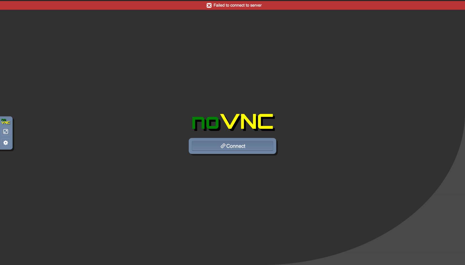

Just another attachment; this is what is seen at the exact same time the VM goes down (and the error is logged as posted above).
NOTE: if trying to access the VM through any other means (RDP, RealVNC, TeamViewer, Linux-standard VNCs, etc), no issues are noted. The crash happens every time with noVNC/clicking the VNC button in the FreeNAS webUI.
