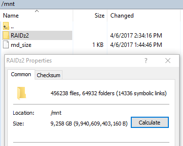

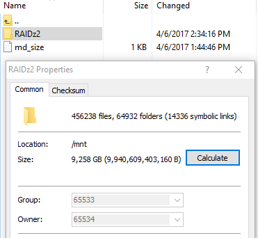

this only finds 9.25TB, as the other inquiries also found. I just don't understand - where's it hiding?
I also calculated all of the other directories above the /RAIDz2 and only found 2,5GB or so.

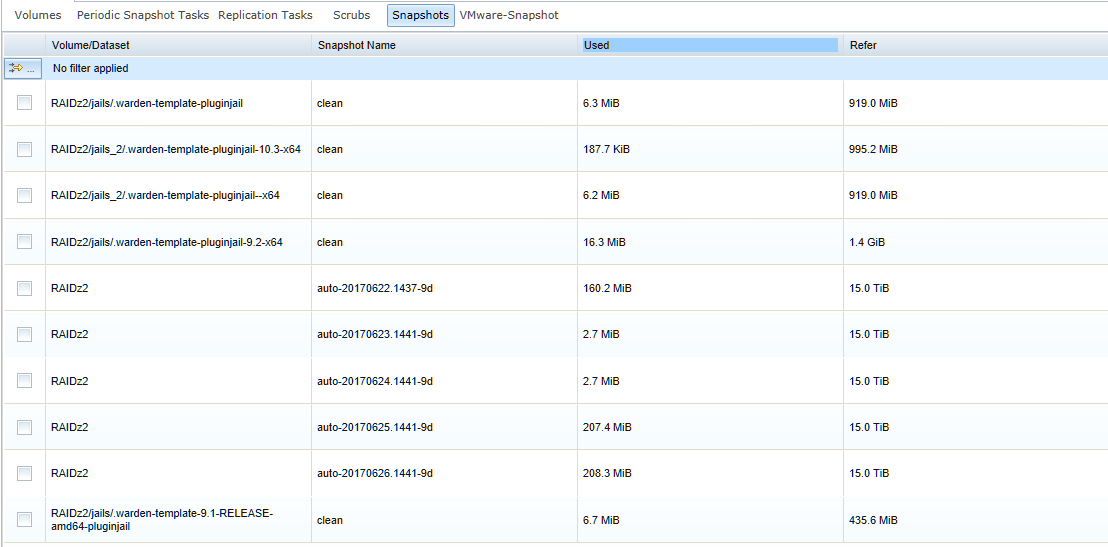

I did run into this problem a few years ago where the snapshot cycle was way out of line. I've fixed this since then with a frequency of 1 day, being deleted after 9.
Here's a list of my current snapshots, am I missing something obvious here?

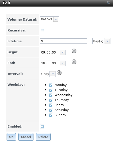

Could you show your snapshot tasks, please.
I'd then do a full external backup of your important information and then start deleting all the snapshots that are directly associated with the media files. As long as your critical data is not included in the media files snapshots then there would be little worry to delete every media file location snapshot.
is this what you are asking for?

This screen: Storage>Periodic Snapshot Tasks
asw2012
Dec 17, 2012
182
diedrichg
Dec 4, 2012
1,319
Hmm. A lifetime of 9 days. Has it been >9 days since you started noticing the storage space go missing?
