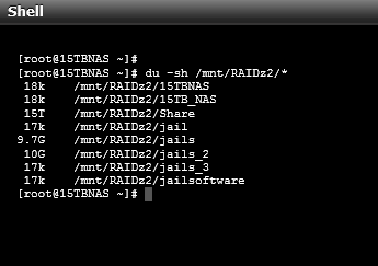

What is the output of the following command?
du -sh /mnt/RAIDz2/*

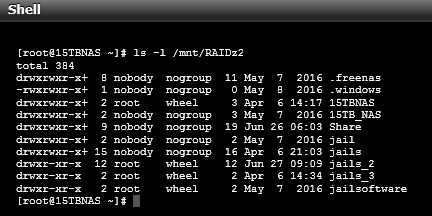

What's the output of ls -l /mnt/RAIDz2?
asw2012

One way or another, you have 15 TB in /mnt/RAIDz2/Share. What does du -sh /mnt/RAIDz2/Share/* show?
Yes, and Share doesn't show up in the OP's zfs list -o space output or either of the pool status screenshots. Seems to be simply a directory in /mnt/RAIDz2, much like it was created from the shell and not as a dataset via the WebGUI.

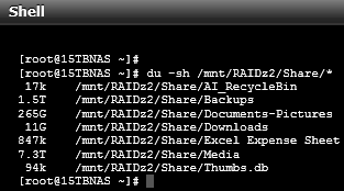

I see a max of 9.2TB +/- a few GB

15,504
OK, so nothing significant in Share itself (as opposed to its subdirectories). du isn't the best tool for determining space used with ZFS, but I'd expect it to do better than being off by 50+%. Curious.

@asw2012: your screenshots are chopping off part of the command output; makes it hard to see what's going on.
The output of du -sh /mnt/RAIDz2/* you posted above shows that the /mnt/RAIDz2/Share directory contains 15TB of data; this is where your problems lie. Unfortunately, this is just a directory on your system; you didn't create it as a dataset using the WebGUI. So it doesn't show up in the WebGUI at all. I mentioned all of this earlier in the thread.
This would be easier to explore if you install WinSCP or a similar tool.
In any case, run du -sh /mnt/RAIDz2/Share/* to see which directories in /mnt/RAIDz2/Share are using the most space. Then go from there to see about deleting unnecessary files.
15,504
In any case, run du -sh /mnt/tank/RAIDz2/Share to see which directories in /mnt/tank/RAIDz2/Share are using the most space.
He did that above. Strangely, the directories in Share only total a little over 9 TB, and there's nothing significant in the root of Share either.
No, sir, he ran ls above. Unless I missed something?
We haven't yet seen his results from running du on the Share directory.
15,504
I think you must have. I refer you again to this post, where, in response to my request, he appears to have run du -sh /mnt/RAIDz2/Share/* (admittedly, it's only "appears to have run", as he cut off the full command). The output from that command is also cut off, presumably to mask directory names, but it's still there.
yes. did not want to show the directory names, that's all. du -sh /mnt/RAIDz2/Share/* was run.
