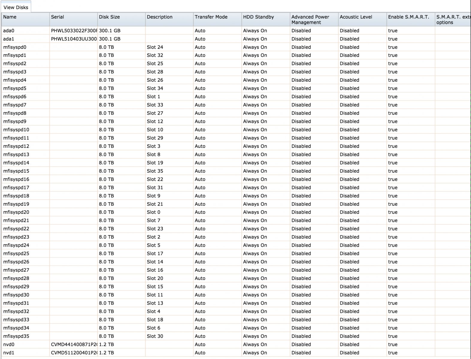

I'm running the current stable version of 9.10. Currently none of my SAS disks are displaying their serial numbers in the webui. My two SSD and two NVME devices are reporting them correctly. All the problem drives are hanging off a AVAGO MegaRAID SAS controller.
Also possibly related. I added descriptions to all of these disks and they didn't survive after my web session.
I have attached a screenshot, that shows the missing serial numbers. Those descriptions are now gone also.
Is this a known issue?
Which specific model and what firmware version?
Arwen
May 17, 2014
3,611
Maybe bad news. The MegaRAID is not a HBA, (Host Bus Adapter), if I recall this correctly.
Thus, you may not get SMART data from the drives either. And ZFS may not beable to cause
a SAS / SCSI block sparing.
But, as @Jailer asked, please supply the model of the Avago / LSI card.
Thanks for the replies.
The controller is a LSI MegaRAID 9361-8i SAS 12Gb/s PCIe 3.0 8-Port Controller with 1GB Cache
Here is the relevant snippet from dmesg which contains the firmware version:

Bummer, no real HBA like allready suggested, any chance you could exchange it for a real HBA?
SAS3... Good news is that you may be able to use it with the new software stack, which replaces mfi and does support direct-attach disks. Search the forums for how to use mrsas instead of mfi.
regnock
Nov 30, 2016
4
Switching the driver worked! I now see serial numbers and my custom descriptions appear to be sticking. Thanks for all the help.
