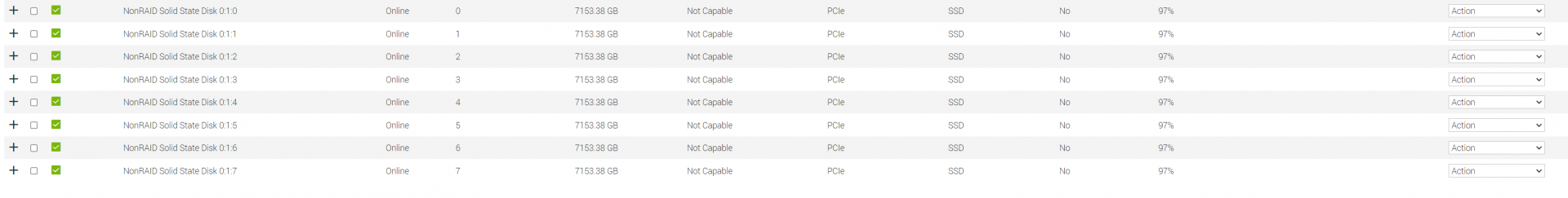

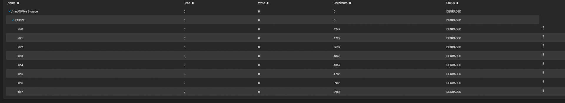

I have recently switched from a Windows Server file server to using TrueNAS, however after I set up TrueNAS, it shows the pool is degraded, and disks are showing checksum errors, but DELL iDrac doesn't show any errors. Before when it was in the Windows Server it was in a raid 6 array with dell H755N raid controller, and it was not showing any errors. These disks are in non-raid mode now, which is HBA mode for Dell disk controllers.
TrueNAS is a virtual machine in VMWare ESXi, but the raid controller is passed through to the VM, so I don't think that would be a issue.
I bought the server new last year, and the disks with the server, so I don't think the disks have failed. Maybe some other error causing this?
Here are some screen shots of the server disk info:

If you're saying you've flashed the controller into IT mode and you have passed through the PCIE device to the VM, great.
I don't understand what that second picture is in your first post... seems like not a screen from TrueNAS, so it's a little strange to have a full view of all disks from ESXi or whatever if passthrough was done properly.

Second picture is from Dell iDrac, which is Dell version of IMPI. Cannot see the disks from ESXi.
