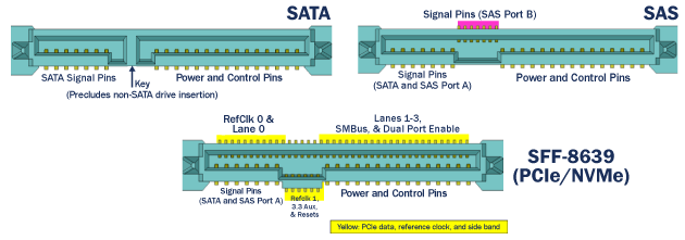

How are the NVMe drives attached to the motherboard?
As identified further down, the concise answer is "they aren't" - despite sharing a similar form factor to 2.5" SATA/SAS SSDs, 2.5" NVMe U.2 drives require a backplane and connection that is compatible with the NVMe protocol.
033c-demartek-sff-8639-png.57054
Only slots 20-23 on the backplane have the necessary pins to be compatible with the U.2 format, but the R730xd itself also likely requires Dell part number 0P31H2 (a PCIe x16 to 4x4 breakout board) in order to actually connect those PCIe lanes through to the motherboard.
