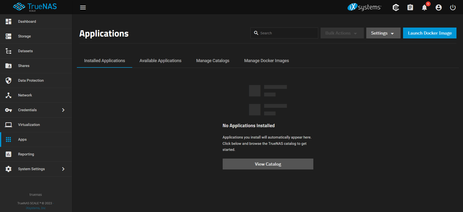

However, as I went to navigate to the apps section I noticed that all my installed apps were suddenly gone. (see picture 1)

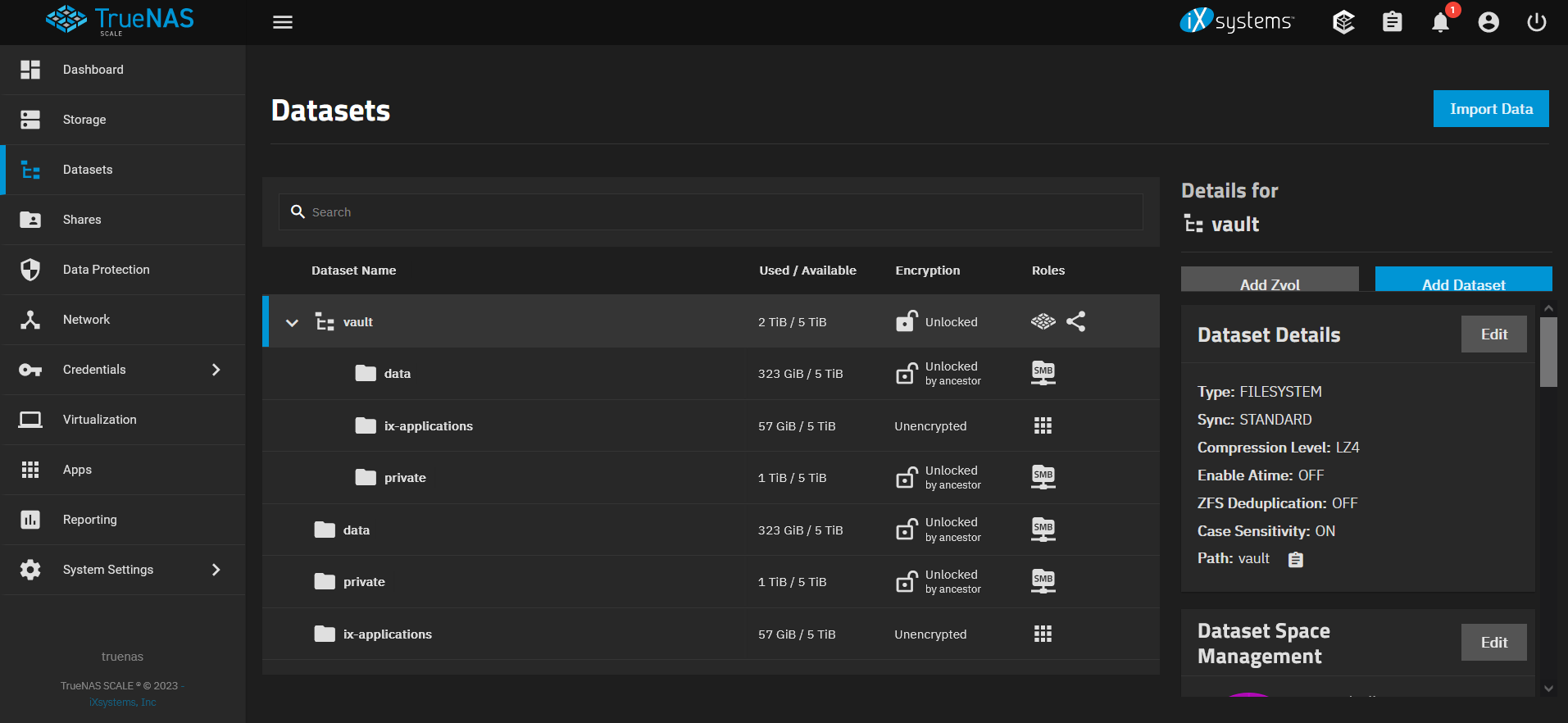

Another weird thing is that my datasets seem to be duplicated. Normally only the 3 datsets under vault were there and now they are listed as extra items below. (see picture 2) Is this something weird or does this have to do with the ZFS update?

Ok thank you, I just did. Hard refreshing did not help, unfortunately. There just appeared a "Initializing Apps Service" message when I navigate to Apps.
Another interesting thing: When I go to Apps - Settings - Choose pool and I select "vault" and click "Choose", I get "Error: [EINVAL]
kubernetes_update.force: Missing
'/mnt/vault/ix-applications/config.json' configuration file. Specify
force to override this and let system re-initialize applications."
So my assumption would be that Truenas maybe can't find the ix-applications dataset. Or maybe the datasets are messed up right now because they show up two times? I am not entirely sure what to do from here. Everything worked great before the update. It would be great if there is some way to fix this without just nuking the datasets and installing and setting up all apps again.
