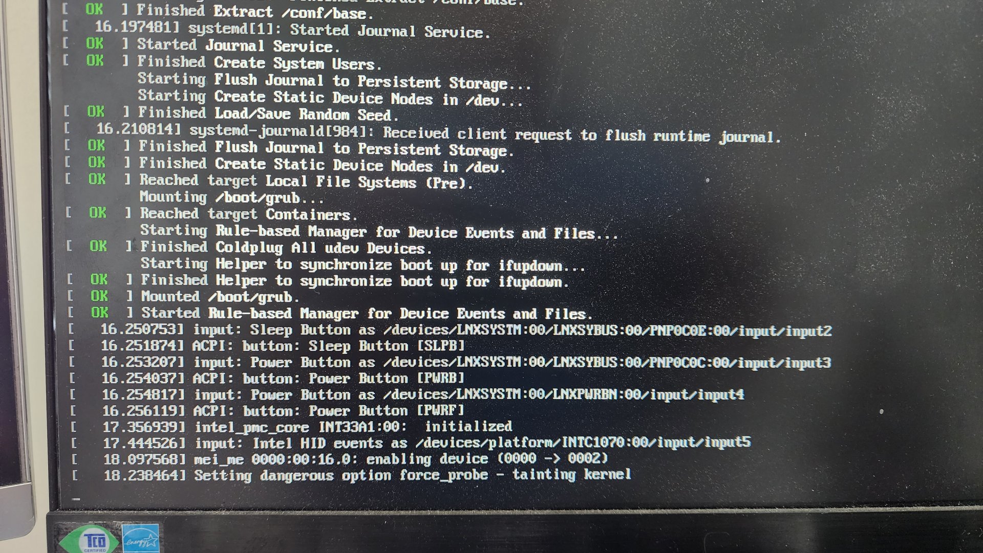

UPDATE:
It appears that after applying the "tunable" that Truenas is actually booting (I did not previously check the GUI :rolleyes:). The console, however, freezes up. In addition, the Quicksync GPU is not made available in the drop-down in the app configs.
Running dmesg from the system shell, I see the block of messages below.
Per the bold text, it looks like the system is turning off the console for some reason. :confused: I suspect that may be occurring in anticipation of the enablement of the Intel GPU (which subsequently fails):

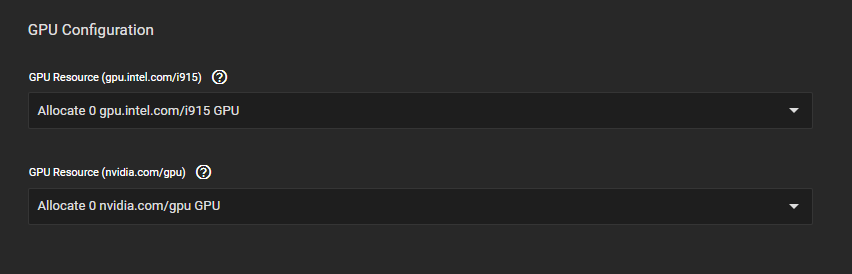

The GPU continues to be unavailable to apps.
Any help is welcome

Problem:
I recently moved my Truenas Scale install to a Z790 motherboard and DDR5 RAM (same procesor - full hardware listed below). On boot, this locked up with the message:
Setting dangerous option force_probe - tainting kernel
Here's the console view:
Steps taken so far:
  1. I performed a fresh install, which successfully booted.
  2. I restored my previous config file and rebooted. The boot froze again with the above message.
  3. I did another fresh install, which successfully booted.
  4. I then ran the command to enable the Alder Lake GPU. On reboot, it again froze with this message.
This would appear to narrow it down to the command that enables the Alder Lake GPU.

I decided to try reverting to my previous 22.12.0 build.
With that, I am able to apply the midclt command to probe for the GPU without any dmesg complaints about missing kernel files.
midclt call system.advanced.update '{"kernel_extra_options": "nomodeset i915.modeset=0 i915.force_probe=4680" }'
Note that I added "nomodeset" (that I learned from other posts), which avoids the console freezing up during boot.
After reboot, dmseg looks a lot cleaner:
admin@truenas[~]# sudo dmesg | grep i915
[ 0.000000] Command line: BOOT_IMAGE=/ROOT/22.12.0@/boot/vmlinuz-5.15.79+truenas root=ZFS=boot-pool/ROOT/22.12.0 ro libata.allow_tpm=1 amd_iommu=on iommu=pt kvm_amd.npt=1 kvm_amd.avic=1 intel_iommu=on zfsforce=1 nvme_core.multipath=N nomodeset i915.modeset=0 i915.force_probe=4680
[ 0.021871] Kernel command line: BOOT_IMAGE=/ROOT/22.12.0@/boot/vmlinuz-5.15.79+truenas root=ZFS=boot-pool/ROOT/22.12.0 ro libata.allow_tpm=1 amd_iommu=on iommu=pt kvm_amd.npt=1 kvm_amd.avic=1 intel_iommu=on zfsforce=1 nvme_core.multipath=N nomodeset i915.modeset=0 i915.force_probe=4680
[ 18.817099] snd_hda_codec_hdmi hdaudioC0D2: No i915 binding for Intel HDMI/DP codec
I'm not sure whether the snd_hda_codec_hdmi line is an issue, but regardless...
With this install, I now have options under the GPU Configuration for Plex. Unfortunately, clicking on the drop-down for the gpu.intel.com/i915 does not give any options other than that currently shown ("Allocate 0 gpu.intel.com/i915 GPU"). Note that I used to have an nVidia GPU before I migrated from a old i7-2600K, however that is no longer present.
The struggle continues...

Final update on this.
I reverted to my Asus Prime H670-Plus D4 motherboard, reversed the above changes and used only the previously successful command for this platform:
midclt call system.advanced.update '{"kernel_extra_options": "i915.force_probe=4680" }'
After a couple of reboots, the Quicksync GPU options appeared again on the app edit screen (0-5 selectable). I selected 5 for Plex and re-deployed. I then verified that Plex showed hardware acceleration with two concurrent 4K transcodes, with CPU usage under 10%.
