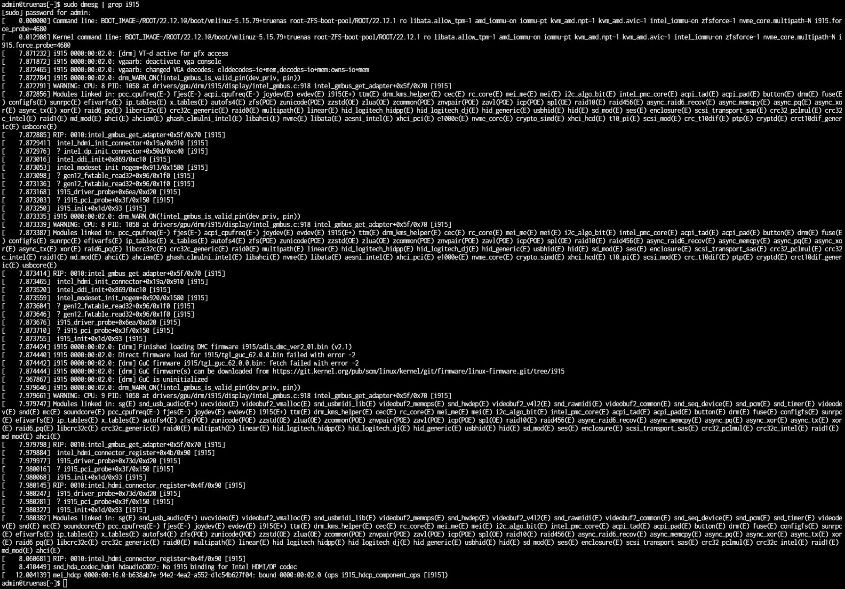

On a fresh install I'm not able to select a GPU in the app settings:
https://www.truenas.com/community/t...ick-sync-on-newer-intel-cpus-in-scale.100046/
sudo midclt call system.advanced.update '{"kernel_extra_options": "i915.force_probe=4680"}'
When I follow the instructions in the above post and run the the above command I'm still not able to pick a GPU in the app setting and when I run a sudo dmesg | grep i915 I get the error message attached. Also the boot screen stops at the line "drm vt-d active for gfx access"
I tried running midclt call system.advanced.update '{"kernel_extra_options": "i915.force_probe=4680 nomodeset i915.modeset = 0"}'. With this command I get this error:
[ 0.000000] Command line: BOOT_IMAGE=/ROOT/22.12.1@/boot/vmlinuz-5.15.79+truenas root=ZFS=boot-pool/ROOT/22.12.1 ro libata.allow_tpm=1 amd_iommu=on iommu=pt kvm_amd.npt=1 kvm_amd.avic=1 intel_iommu=on zfsforce=1 nvme_core.multipath=N i915.force_probe=4680 i915.modeset=0
[ 0.013211] Kernel command line: BOOT_IMAGE=/ROOT/22.12.1@/boot/vmlinuz-5.15.79+truenas root=ZFS=boot-pool/ROOT/22.12.1 ro libata.allow_tpm=1 amd_iommu=on iommu=pt kvm_amd.npt=1 kvm_amd.avic=1 intel_iommu=on zfsforce=1 nvme_core.multipath=N i915.force_probe=4680 i915.modeset=0
[ 8.107054] snd_hda_codec_hdmi hdaudioC0D2: No i915 binding for Intel HDMI/DP codec
What am I missing or doing wrong? I have a another Scale system with the same proc and Intel Quick Sync works without any issues.
  • iGPU Error.txt

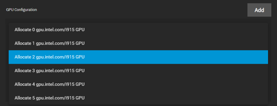

I have the same motherboard with the same problem and tried the same command, except swapped 4680 for the number my system called for. Where did you find your solution? When selecting your GPU in the dropdown in the TrueNAS GUI, does yours show "Intel Corporation Device 4680"?
Luke99
Mar 14, 2023
4
It looks like this in Apps for me.
