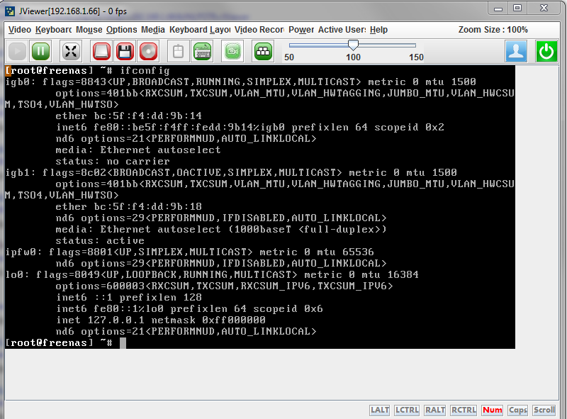

Well I removed the static setting from the router and setting it on FreeNAS instead... no luck. Then I reset the network interface on freenas... rebooted the router for good measure. FreeNAS doesn't show up in my router device list at all. I tried switching to the other NIC... same result: no IP. I get link lights on both the NIC and the router and I tried the working cable that I'm using for IPMI to further rule out a bad cable. IPMI works fine.
Here's what ifconfig gives me from the shell... I can see there's no IP, but there might be more information in there that would help... I just don't know what it is.

Well, I certainly can't explain it, but after deleting the interface it finally started getting a DHCP IP... I did the router mapping again to get the IP, but now setting a static seems to work so I'll just leave it at that. Seems to be working ok now.
