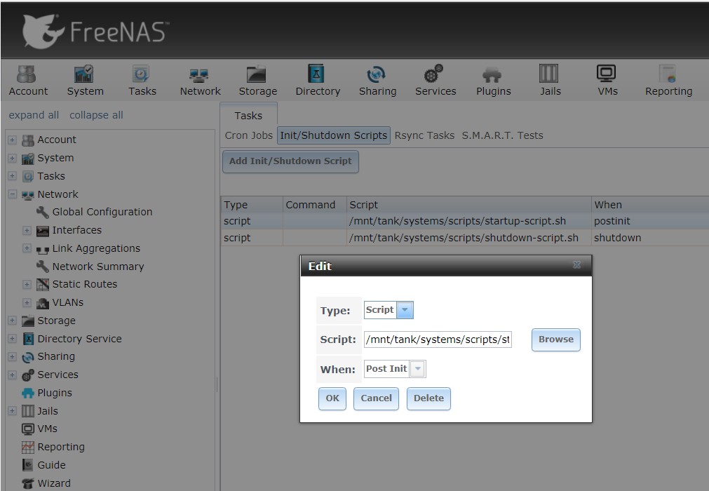

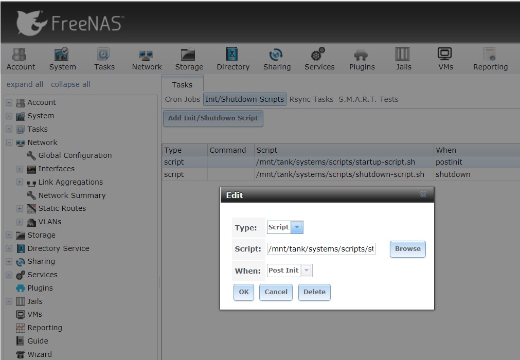

Then add this script as a Post Init startup task in FreeNAS. The Post Init specifier is important. See image for an example:
