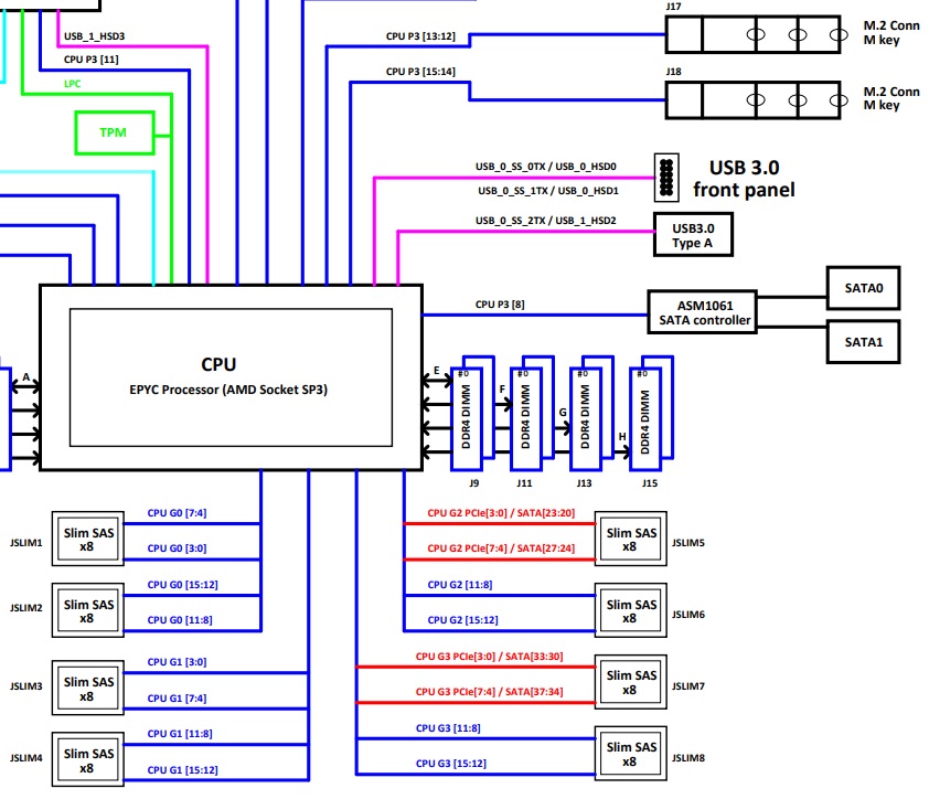

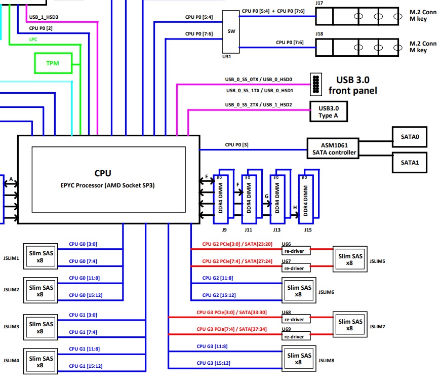

ehsab
Aug 2, 2020
45
I'm leaning towards the AMD build with 10x 1,9TB disks.
There are two different motherboardoptions, H11SSW-NT and H12SSW-NTR (which is newer).
However when reading the motherboard manual two things strikes me.
1. On two of the PCIe lanes from the motherboard (H11SSW-NT) to the nvme slots there is a "re-driver" inbetween. Whats this for? Is this something to consider or will it has no impact on the nvme performance?
The newer motherboard does not have this re-driver.
2. There is a switch(?) between the CPU and the two M2 slots on H11SSW-NT, i assume this is for enabling x4 to one slot if the other is not being used. Is this something to consider or will it have no impact if i only use one M2 disk?
The H12SSW-NTR does not have this switch, but on the other hand both M2 slots are PCIe 4.0 only. What impact will this have for my P4801X?
I would however like to mirror two P4801X disks so either way i'm stuck at x2, but the old is PCIe 3 x2 and the new is PCIe 4 x2. Is this a bad idea?
