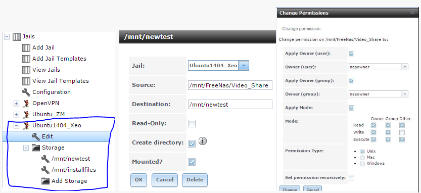

Hi
I am following https://doc.freenas.org/9.3/freenas_jails.html 13.2.1.2 to give my Ubuntu 14.04 VM access to a dataset in the Freenas storage area.
Freenas sees the folders created in the VM, but from within the VM they aren't there.
I have attached a couple of screenshots, from Freenas and from the Jail, to illustrate what I am seeing.
From Freenas:
Inside the VM:
root@Ubuntu1404Xeo:/mnt# ls -l
total 0
nasowner@Ubuntu1404Xeo:/mnt$ ls -l
total 0
I think this is some sort of permissions issue, but I am not sure how to proceed, and help would be very much appreciated.

I don't think it's a permissions issue. Is Video_Share a dataset (did you select it using the file tree?)? What does the Jails->Storage tab look like? Does Video_Share show as mounted?

Try creating the mount point inside the jail. For a long time the create directory checkbooks hasn't worked.

Thanks very much for your responses. My Jails -> Storage tab shows both 'newtest' and 'installfiles' as mounted. I did add Video_Share using the file tree in the jail 'Add Storage' dialogue.
So, I went in and created the 'newtest' folder <is that the same as 'creating the mount point'?> inside the jail, and added a couple of text doc's. I deleted the 'newtest' storage from the Jail in Freenas, then re-added it using the 'Add Storage' dialogue. Looking at Video_Share from Windows, I can't see the files I had created in the Jail's 'newtest' folder - guess they didn't make it on to Video_Share. Looking the other way, from the Jail, I couldn't see the video files on the Video_share dataset.

Adding the text document in the jail means nothing. When you mount to that directory they will not be accessable. In the jail what happens if you type 'mount'?

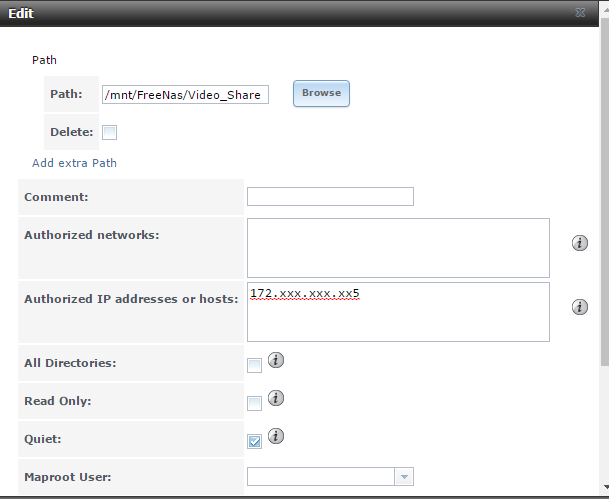

  • Do you have an NFS share set up for /mnt/FreeNas/Video_Share?
  • Is the NFS service running on your FreeNAS box?
  • Do the settings of the NFS share allow the VM's IP address to connect?
  • Does your Ubuntu VM have a good network connection to your FreeNAS box? Can you ping the FreeNAS IP address, for example?

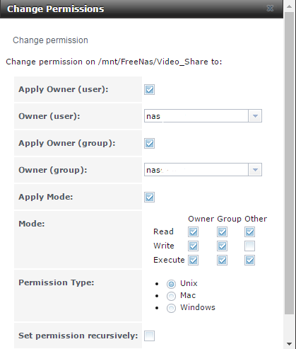

permissions on the dataset itself are as follows:
making progress - thank you!

I've now set up a NFS share for /mnt/FreeNas/Video_Share. Hadn't done that before as I assumed (!) the 'Add Storage' sorted that out.
Nope, completely different things. What you're trying to do really doesn't have anything to do with adding storage to your jail, and I'd probably delete that storage mountpoint--it unnecessarily clutters things.
Try clearing out the "authorized IP addresses" field on the NFS export, and see if that makes a difference.

Most excellent! Cleared out the authorized IP addresses, re-booted the VM and FreeNas, and I can now see the share! Thank you very much indeed.
I can't quite write to the share from the VirtualBox VM, but that is another thing....
nas@Ubuntu1404:/usr/share$ ls -l
drwxrwxr-x   7 nobody:65533      40  Sep 23 00:17 mount
(as it happens, I can write to that share from my Windows box on the same network)

I have sorted (? - botched) the VirtualBox Ubuntu VM permissions issue for now by setting the NFS share in FreeNas to 'Mapall User: nobody' 'Mapall Group: nogroup'. It's probably hideously unsecure but it works for now!
