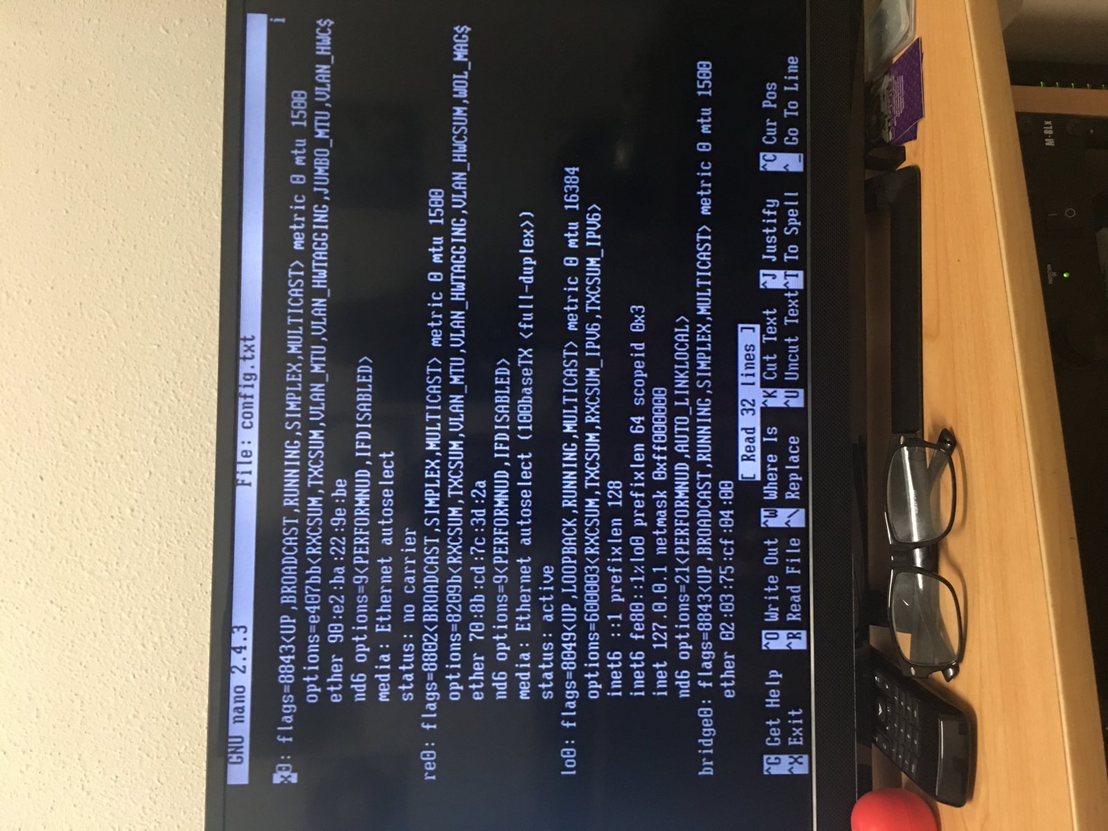

Paste the output (or a screenshot) of ifconfig within code tags.

dsjevo1
Oct 11, 2016
5
Here is the correct image

D
dlavigne
Guest
Well, there's no carrier on the Intel. Check the cabling to the switch.

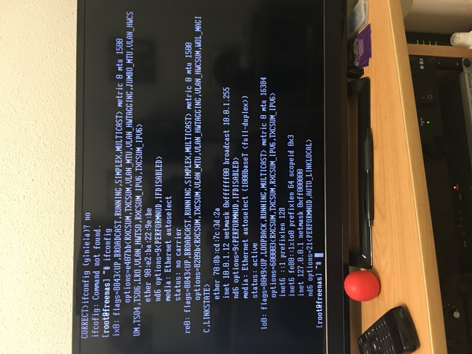

dsjevo1
Oct 11, 2016
5
Connected the SFP cable to the switch, still unable to access the control panel.

D
dlavigne
Guest
As long as the entry under "ix0" says "no carrier", you have no connectivity. There's either a problem with the card or the cabling.
