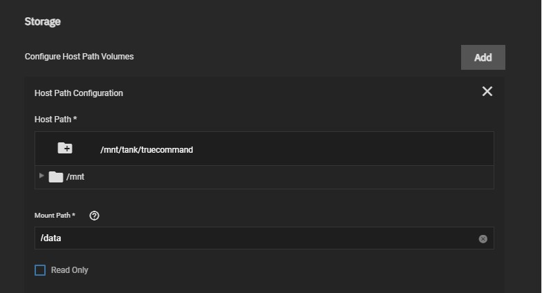

When multiple containers are involved in setting up an app, a TrueCharts Custom-App is the only option available as docker-compose is not officially supported under SCALE. For simple apps that do not require container orchestration, it's easy enough to add storage through the GUI. In the example below, external pool storage (/mnt/tank/truecommand) is mapped to internal container storage (/data). The docker instructions for Filebrowser suggest it falls in the group of 'simple' single container apps.
