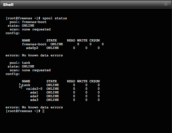

I was pretty sure I didn't imagine this, so I checked man zpool and it says:
A raidz group with N disks of size X with P parity disks can hold
approximately (N-P)*X bytes and can withstand P device(s) failing
before data integrity is compromised. The minimum number of
devices in a raidz group is one more than the number of parity
disks
. The recommended number is between 3 and 9 to help increase
performance.
So I fired up a VM, attached 4 virtual disks and installed FreeNAS on the first. Sure enough, the GUI won't let you make a RAIDZ2 pool with 3 drives, because it's silly, but zpool will do it at the command-line without any complaint.
