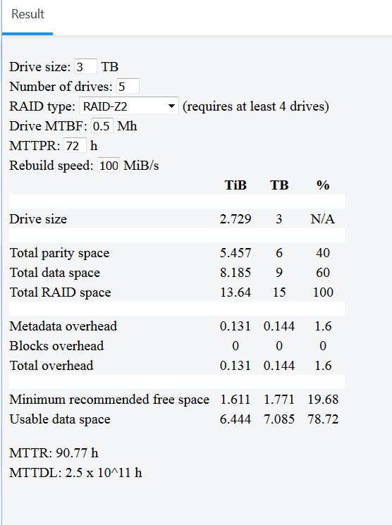

And please confirm my maths - 5 x 3Tb Drives in RaidZ2 ought to give me 9 Tb with 2 drive redundancy.
From @Bidule0hm calculator, please click here
If you intend to stay below the 80% capacity recommendation,
your "usable" space would be a fraction over 7 Terabytes or 6.444 Tebibytes

BigDave - Well, that's a bugger and much lower than I'd anticipated. Worse, is that the 4 drives I currently have will, by that standard, only give me 4.7Tb of storage. (edited due to swear filter interference, which I'd prefer to avoid). "Oh tarnation, how frustrating".
No doubt the % use of the pool is written somewhere but I've obviously missed it.
Looks like I'll have to buy another Red - so have the 5 in total, and hope that lasts me for the foreseeable future. (It should). That's really pushing the budget so a 6th HDD is out of the question at the moment. But thanks Z300M I'll consider that if/when the time comes :)
