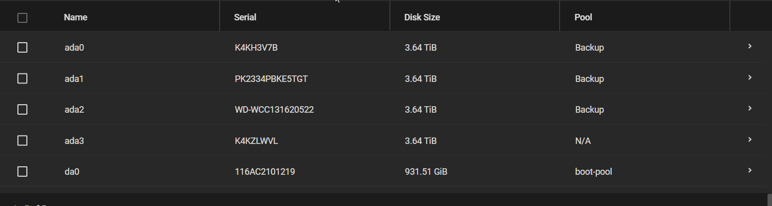

Here is a pic of the drives showing n/a in the pool. But online and healthy finally.

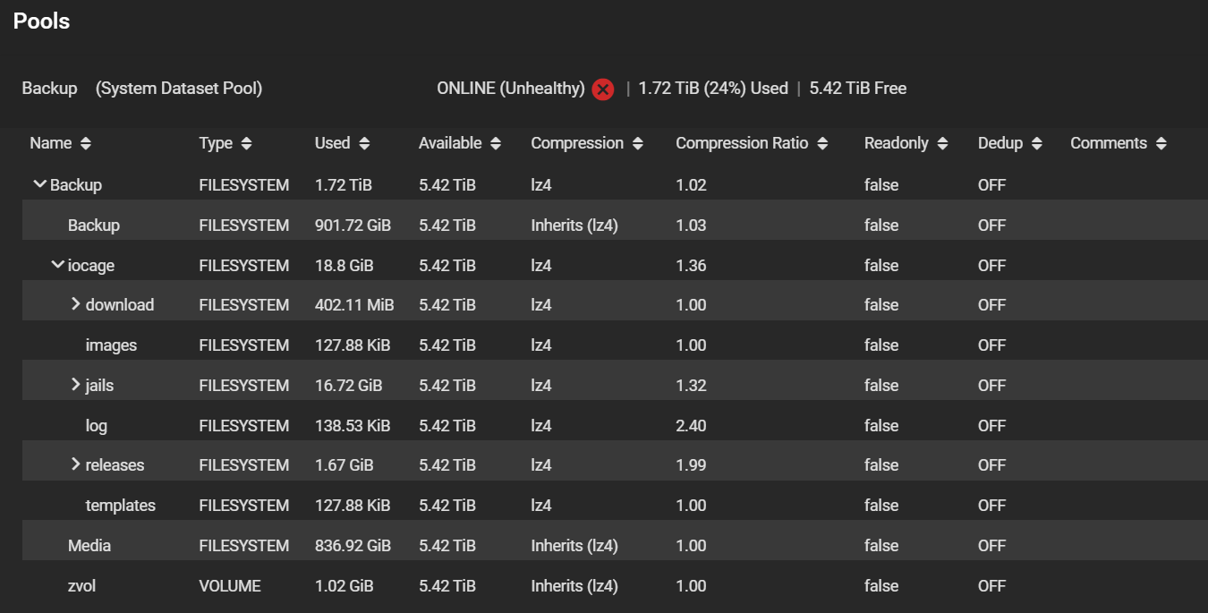

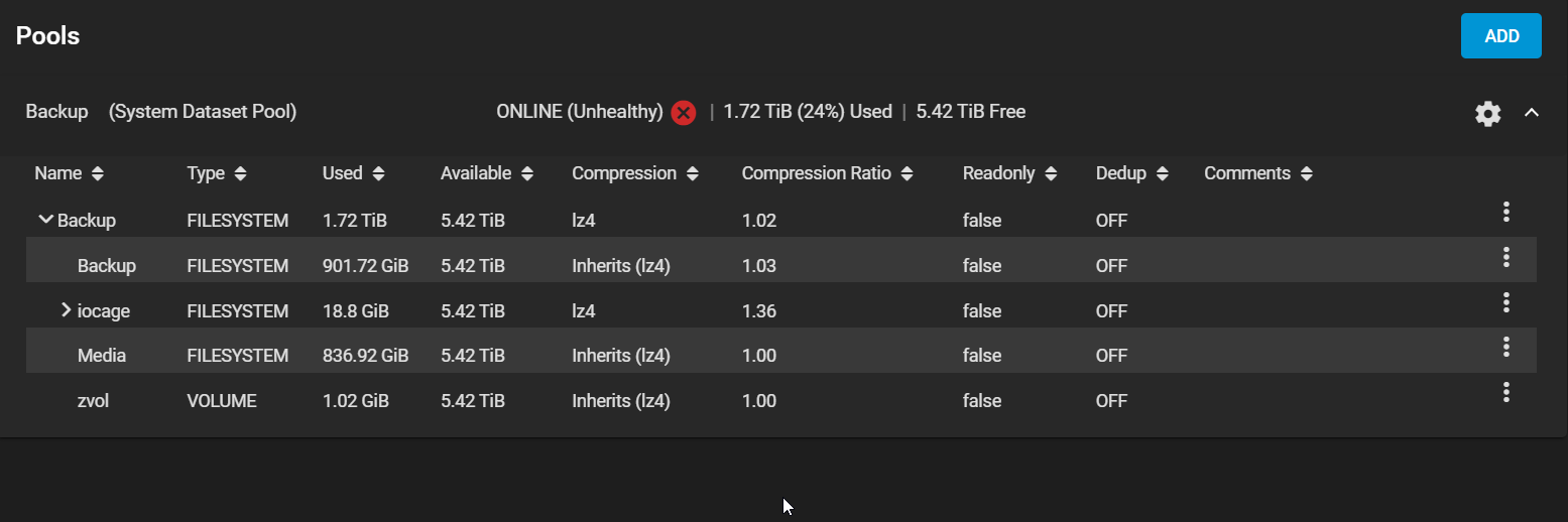

Edit- Here is a pic of the pool. I think the unhealthy is because of the missing drive. But I could be wrong

Sorry I thought the pic showed drive sizes. All 4 are 4tb drives or showing as 3.64tb in the system.

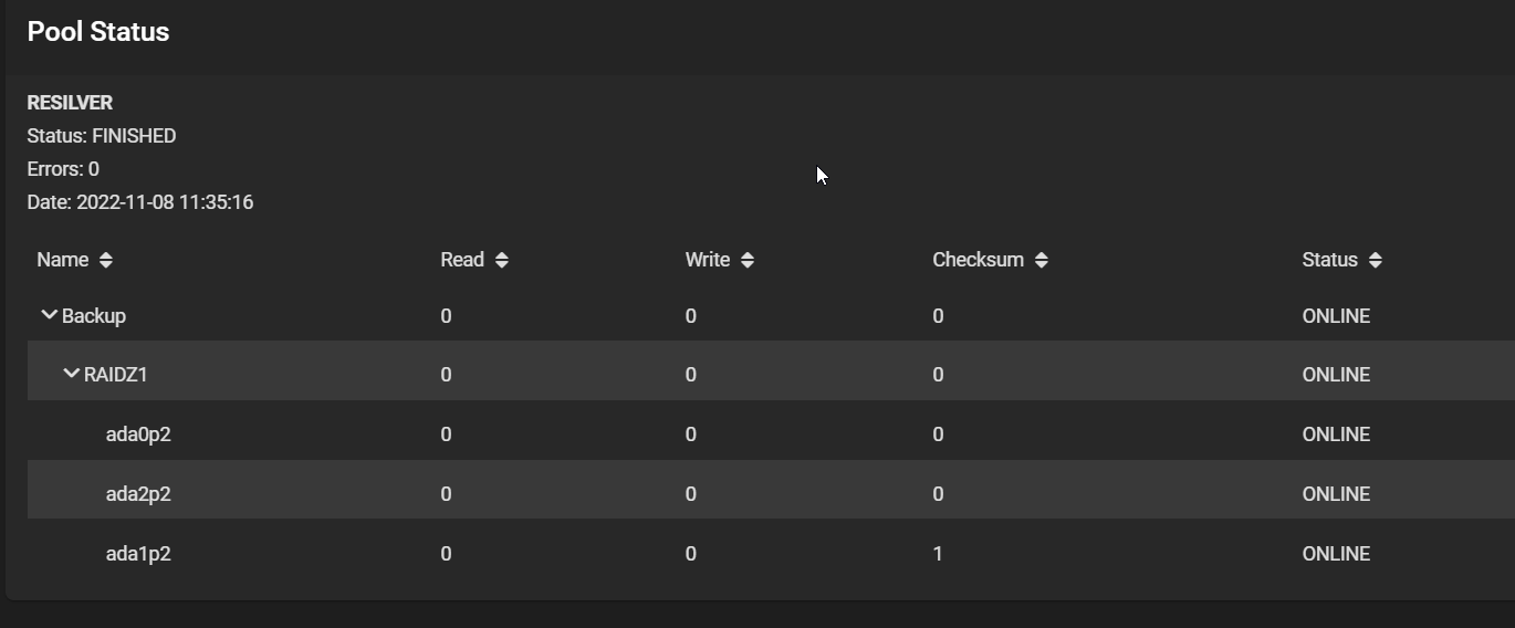

Can you show us the pool layout, please?
You can show the pool layout either from the web UI (Storage / Pools / Pool Status) or from the shell (zpool status)
If it's just a matter of one drive in a mirror having gone offline, you can attach it there - but if you're looking to expand capacity, that may not be possible.
This is the storage/pools-

That's what I was afraid of.
Sorry, but there are no current provisions for RAIDZ vdev expansion. You'd have to migrate all of the data off, and then destroy/rebuild the pool.
darn.
So in your opinion. IF I copied all the data off network folders into a external drive. delete the pool, remake. recreating the network drives for my family links. I could then put the data back? Data being back ups, movie/music files.

Anyway, @HoneyBadger has confirmed my initial suspicion-based diagnosis. Yes, copy to another destination, delete the pool, add the 4th HDD, make a 4-drive pool, copy data back.
