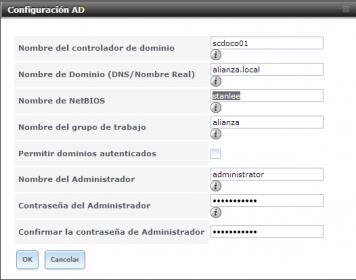

Hi everyone,
I have FreeNAS-8.2.0-RELEASE-p1-x64 (r11950) on my server... I want to integrate with my Domain Controller (Windows Server 2008 R2)

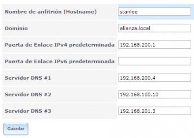

The next image is about network config.
When i try to turn on the AD service, it appears a notification "the service could not be start"
Thks

Enable log ( Settings - Advenced - Show console messages in the footer).
Retry turn on the AD service and click on footer console...
What was written while trying to connect with?
Errors can occur in the following services ... NTP, DNS, CIFS, AD
P.S. It is better to go to 8.3.0!
