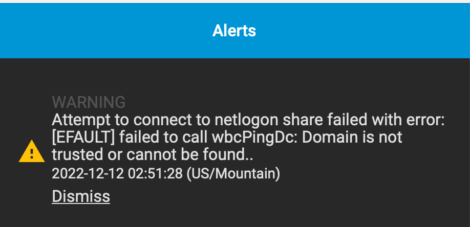

I have 2 servers receiving audio and data files from 2 call center workstations and about every 4 days I have to disable and re-enable the Active Directory connection. I am connecting to Windows 2008 r2 OS on the domain controllers.
I am using Dell rack mount servers with 96GB of memory and red drives for the arrays.
I have attached a screenshot of the error message I get.

Hmm... that error message often can indicate that we transitioned to a speaking to a DC where our computer account password is not accepted. Alternatively, it could mean that time is significantly out of sync with the DC we were trying to talk to.
This can happen if there's an issue with replication between DCs in the environment, or inconsistent time on DCs. You can look in winbind logs in /var/log/samba4/ to try to get more info about the auth problem. Alternatively, you can walk the DCs checking net -P -S <server name> ads status to ensure we can auth to all DCs in our AD site.

Hello and thanks for your time and expertise!
I checked the time on all servers before and just now, that isn't an issue.
Replication seems to be working fine I was able to log into both DC's with the same user, and when I make changes to one DC the other gets the updates.
I looked in the logs, I can see where it was having issues with auth at the times it had the error I posted. I don't see anything else, but then my eyes aren't use to looking at those logs.
I ran that command you gave on one of the servers and am getting this:
kerberos_kinit_password TRUENAS@MYTREX.INC failed: Preauthentication failed
Yes 2 lines. So I guess I don't know what that means as the server is currently using AD and allowing writes and reads.
This feels like I am just missing something.

Looks like the stored machine account password in secrets.tdb was rejected and we tried to kinit and failed as well.
net -S <DC name> ads info will show you server time offset which may indicate one avenue for failure (clock being out of sync). If you add -d 5 to arguments list you'll get more verbose output. You can increase debug level to 10 to get more info.
