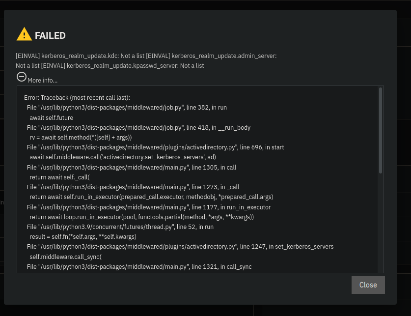

I was working on setting up TrueNAS within a VirtualBox VM, and along the way it became necessary to try connecting it to an existing AD. After making sure the VM was registered on the network and able to ping the outside world, I went ahead and put in AD credentials (domain etc.) And got the following error...

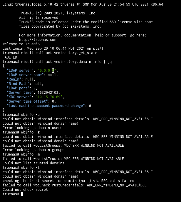

I'm not quite sure how to proceed since I followed some diagnostic suggestions as outlined in another post (Active Direcotry State Faulted! link), and was able to get...
Clearly it's not establishing a connection to the AD, I would just like to know how to read the error and figure out where the problem is.
The full error message traceback is
File "/usr/lib/python3/dist-packages/middlewared/job.py", line 382, in run
await self.future
File "/usr/lib/python3/dist-packages/middlewared/job.py", line 418, in __run_body
File "/usr/lib/python3/dist-packages/middlewared/plugins/activedirectory.py", line 696, in start
await self.middleware.call('activedirectory.set_kerberos_servers', ad)
File "/usr/lib/python3/dist-packages/middlewared/main.py", line 1305, in call
return await self._call(
File "/usr/lib/python3/dist-packages/middlewared/main.py", line 1273, in _call
File "/usr/lib/python3/dist-packages/middlewared/main.py", line 1177, in run_in_executor
File "/usr/lib/python3.9/concurrent/futures/thread.py", line 52, in run
File "/usr/lib/python3/dist-packages/middlewared/plugins/activedirectory.py", line 1247, in set_kerberos_servers
self.middleware.call_sync(
File "/usr/lib/python3/dist-packages/middlewared/main.py", line 1321, in call_sync
return self.run_coroutine(methodobj(*prepared_call.args))
File "/usr/lib/python3/dist-packages/middlewared/main.py", line 1361, in run_coroutine
return fut.result()
File "/usr/lib/python3.9/concurrent/futures/_base.py", line 433, in result
return self.__get_result()
File "/usr/lib/python3.9/concurrent/futures/_base.py", line 389, in __get_result
raise self._exception
File "/usr/lib/python3/dist-packages/middlewared/service.py", line 838, in update
rv = await self.middleware._call(
File "/usr/lib/python3/dist-packages/middlewared/main.py", line 1262, in _call
File "/usr/lib/python3/dist-packages/middlewared/schema.py", line 1092, in nf
res = await f(*args, **kwargs)
File "/usr/lib/python3/dist-packages/middlewared/schema.py", line 1181, in nf
args, kwargs = clean_and_validate_args(args, kwargs)
File "/usr/lib/python3/dist-packages/middlewared/schema.py", line 1175, in clean_and_validate_args
raise verrors
middlewared.service_exception.ValidationErrors: [EINVAL] kerberos_realm_update.kdc: Not a list
[EINVAL] kerberos_realm_update.admin_server: Not a list
[EINVAL] kerberos_realm_update.kpasswd_server: Not a list

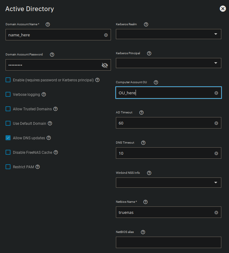

Apologies for not clarifying in the original post, TrueNAS-SCALE-21.08-BETA.1
The flow after putting together the VM and first Zpool was...
Credentials > Directory Services > Configure Active Directory > entered in values (not pictured is the "Enable (requires password) tick" which was ticked)
after which the message from the first post was thrown. I'm trying to understand the messages about Kerberos given that the Domain Account Name + Pass, because some sort of validation seems to be occurring (when I use the wrong pass word, I get the correct error rejecting the attempt).

Yeah, it's a bug. That particular code path didn't get followed in automated testing (basically, in cases where our AD site has many DCs, we populate the kerberos config with site-specific ones rather than entirely relying on DNS to find them).
