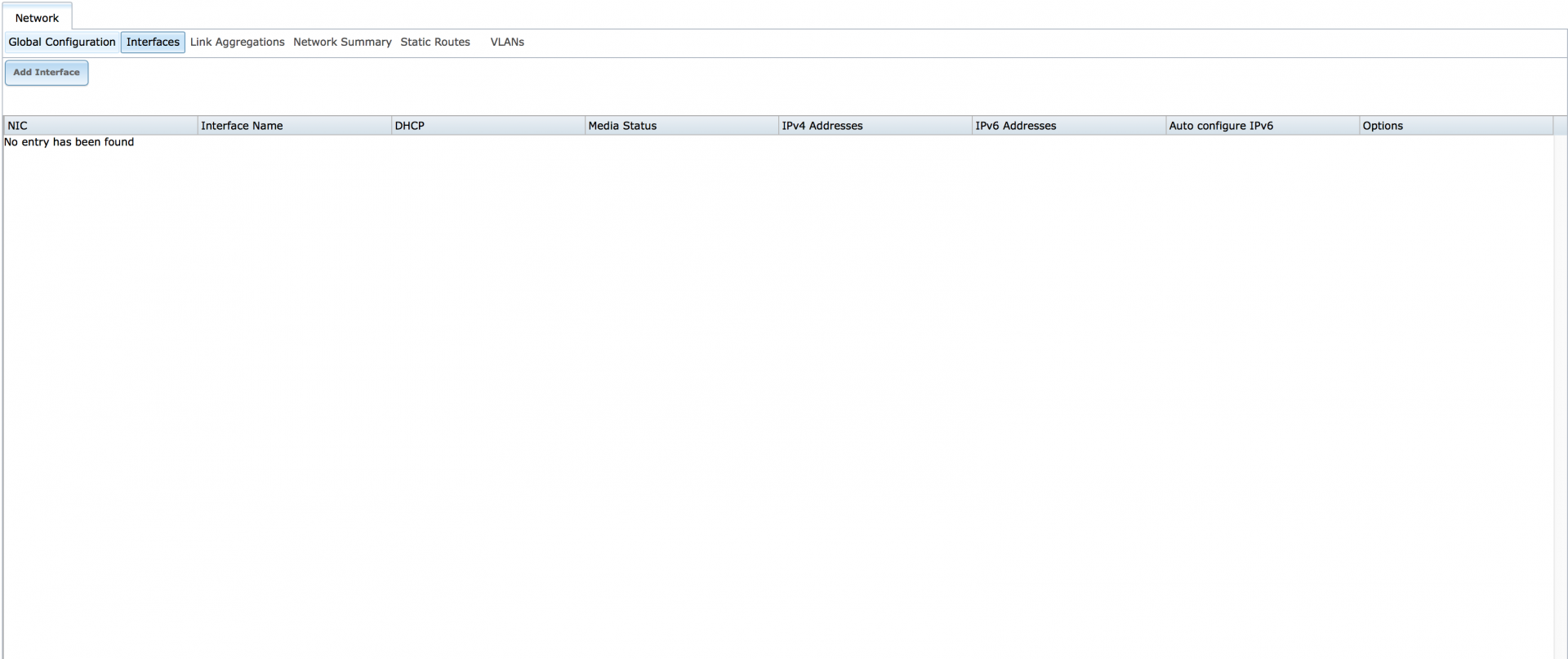

So I think what you're saying is that you have a second IP address defined on re0 on your FreeNAS host which is the same as your jail IP?
Under Network Interfaces in the GUI, what do you see? Have you added aliases to your main interface?
Yes, image attached to what you're referring
