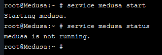

Recently expanded my server and updated to Freenas 11.2 U7. Managed to install everything except for Medusa just fine. The only way i can get medusa to run is to open its jails shell and type in python3 /usr/local/medusa/start.py. As long as i have that shell window up in a tab Medusa runs normally, however if i close the shell window Medusa immediately stops. I used to not have to even start Medusa, it would just do it automatically.
I've tried "service medusa start" in its jail and i get a message saying that it's starting but it never actually does.
Does anyone know what i've done wrong or how to troubleshoot?

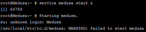

I tried it on the service command and it gave me a few lines i hadn't seen before about an unknown login.

python3 /usr/local/medusa/start.py & (with a space before the &)
DanMaz
Dec 12, 2019
8
That seems to be working so far. I'm able to close the shell window and Medusa is still accessible. What does the & do in this case?
D
dlavigne
Guest
That should work with any shell command. It tells the shell to start it in the background so you can get your shell prompt back (without stopping the command).
