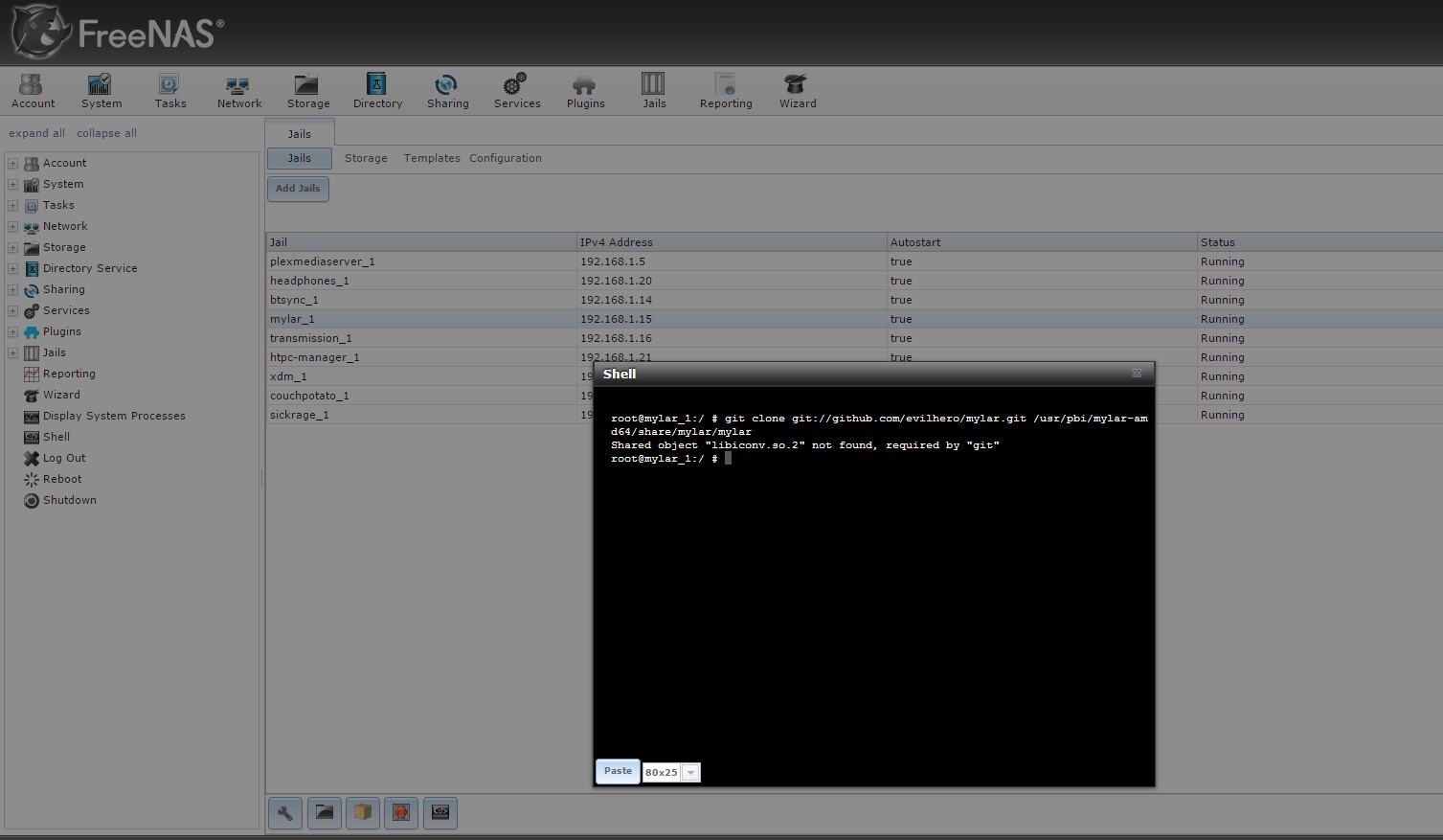

When I enter line three of your code, I get this error back:
Shared object "libiconv.so.2" not found, required by "git"
I was using the shell command from inside the Mylar jail. This was the right place to be yes?

pkg upgrade

Ok that's all good and the git clone went ok
However line 4: 'git checkout development' throws this error:
'fatal: Not a git repository (or any of the parent directories): .git'

forgot you need to
cd /usr/pbi/mylar-amd64/share/mylar/mylar

It all works perfectly now
Thank you for holding my hand through that Josh. You've been a massive help this past week :)

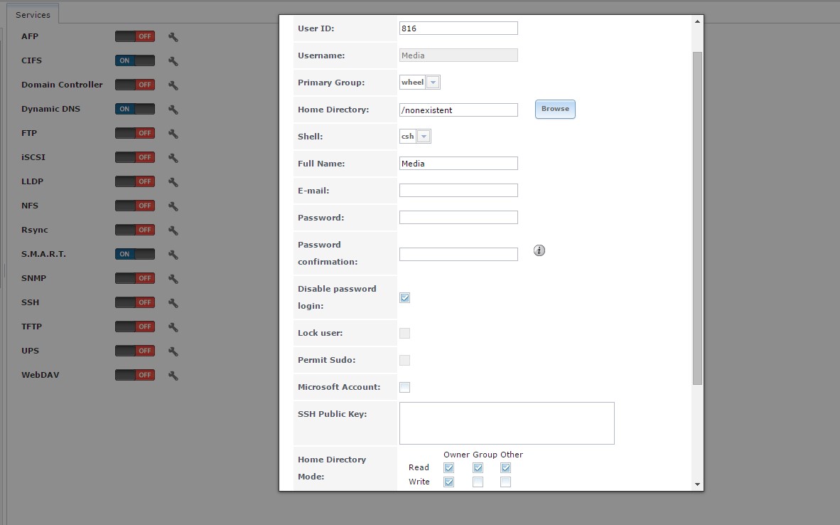

Hey Josh,
sorry to open this thread up again, but I'm having a slight permissions issue with the way I have set things up and I can't seem to fix it
After my colossal balls up the other week when I needed to reinstall all my plugins, I followed your instructions and set up some of my plugins as user/group media:media
That has worked a charm for most of them except for Mylar. The reason being, I access the files that Mylar post processes through a windows machine and files that have an 816 User cannot be opened in the comic reader I use.
I tried to use my pathetically small knowledge of Unix commands to fix this myself and thought that this might fix it:
  1. chown -R root:wheel /usr/pbi/mylar-amd64/share/mylar/mylar
It hasn't made any difference and the new files are still being created with an 816 User
Any thoughts on what I should do?

The command you ran changed the ownership of the application source files, not your actual data. I suggest you undo that so mylar can in-app update itself.
chown -R media:media /usr/pbi/mylar-amd64/share/mylar/mylar
Now, as for accessing the comic files, I'm assuming those reside on a dataset you mounted into your jail. Assuming you're using CIFS, whatever user cifs is accessing files with needs read permissions.
I'm not a cifs experts but what I do in this situation is..
* create a media user, UID 816 in freenas
* set cifs to map everyone to this user for this share
You could also set the dataset permission levels to 777 which would allow any user the read/write files. But, you'd need to make sure newly added files also kept a high enough permission level.

Thanks Josh,
I added a new user 'media' with a UID of 816 (see image below)
However I wasn't 100% sure on how to map everyone to this user for the relevant share. I tried changing the guest user in CFS settings to 'media' but it appears that any user other than 'nobody' prevents the CFS service from starting.
As you mentioned, recursively setting the permissions to 777 is a temporary fix, however as soon as I add a new comic, the problems start all over again

So I've done some tinkering around and I think I've found a solution (I'm just not sure how elegant it is and whether or not it may cause other problems down the line)
I added a new User 'Richard' selected the group 'media'
ticked the box 'microsoft account'
added 'wheel' to the Auxilary groups
added my windows 8.1 user login under email
and ticked all the permission, apart from giving 'other' write access
I also changed the same permissions of my dataset to 'Richard' and 'Media'
It works, but does it look like overkill?

I barely know anything about CIFS, I'm more on the UNIX side of things. sounds like a reasonable solution to me though.
