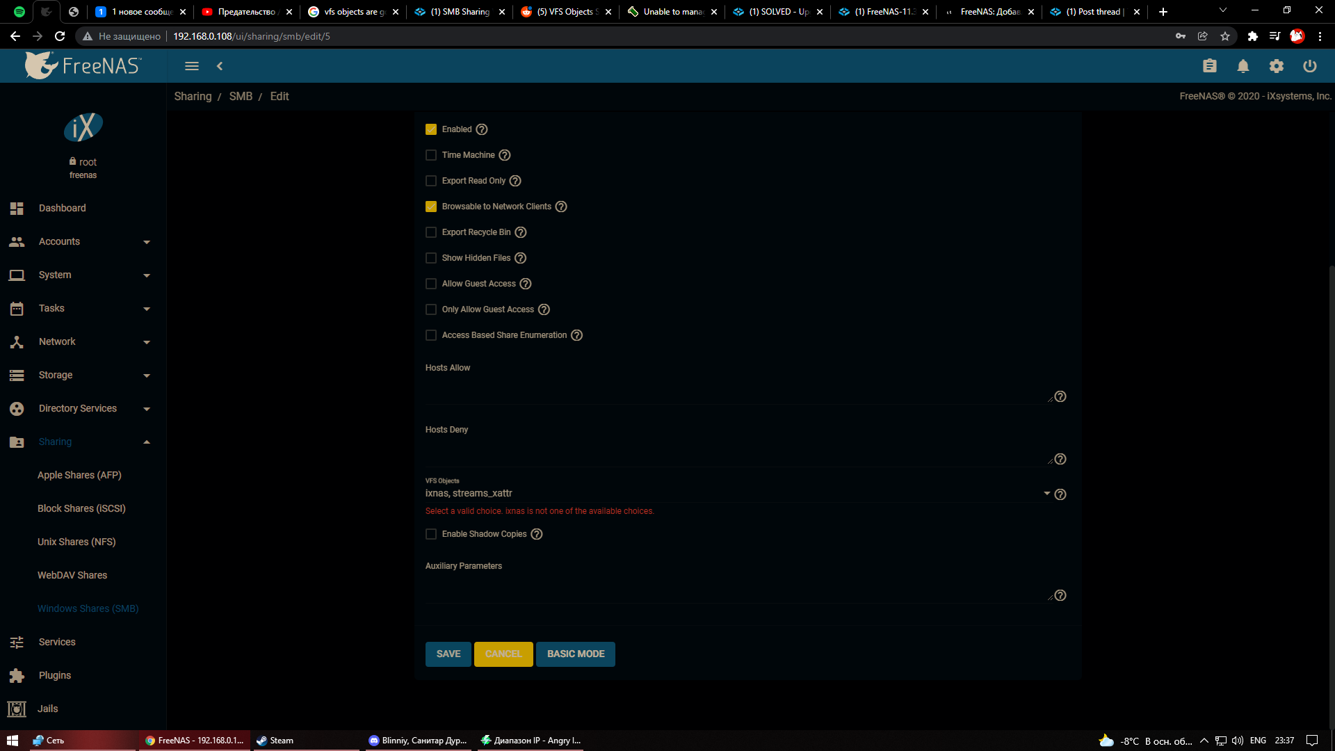

It was the first-ever reboot of my system after which I was greeted with my SMB Share not working. While I was making out what happened I saved my SMB untouched, but an error appeared (see screenshot)
I did some digging on this forum and found out about zfs_space and zfsacl, but when I set them, the error remained
Soon enough I've found out this error is caused by turning any VFS object on, but is not present without it (as well as my permissions)
Thanks in advance to someone who responds to the thread

That's an end-of-life release, just FYI. I believe in the 11.3 branch, we validated the selected VFS objects by listing the contents of /var/lib/shared-modules/vfs. If your boot device is somewhat broken / failing, or someone deleted the vfs modules, then you'll probably have this sort of issue.
That said, there is a _very_ strong case to be made for upgrading.
