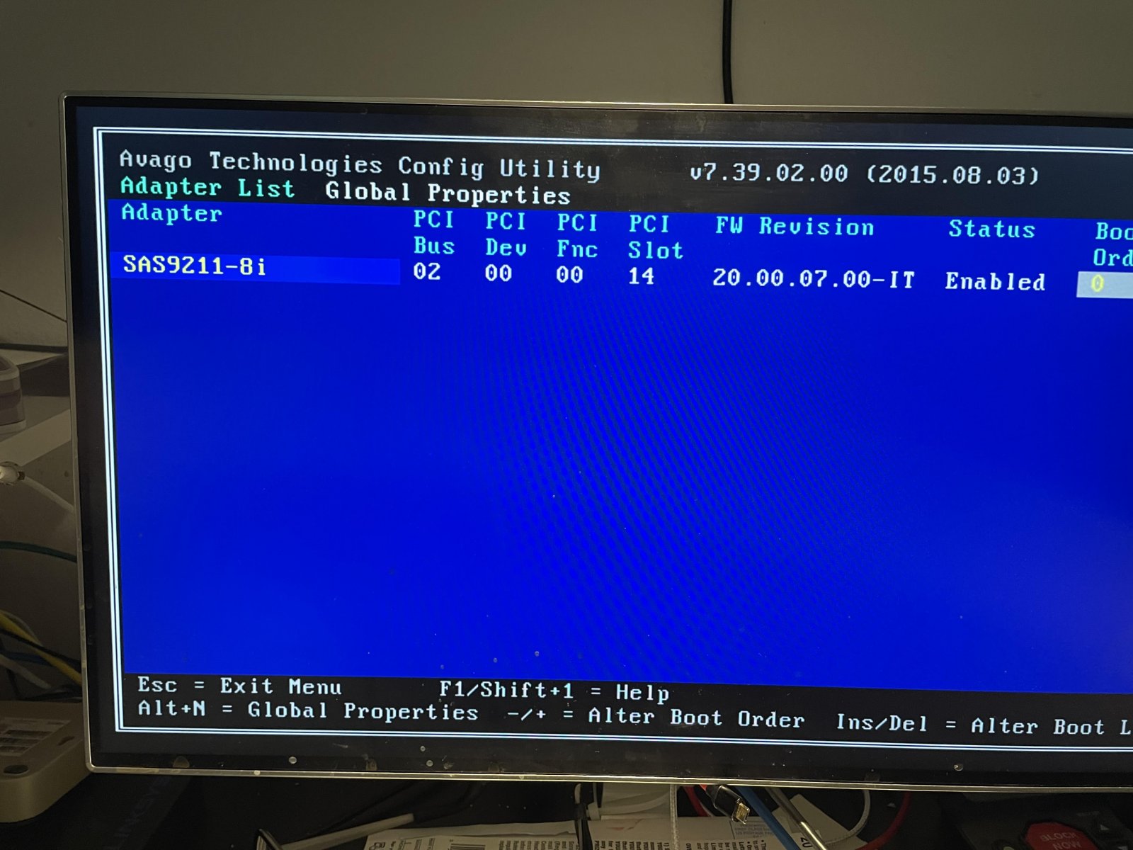

TrueNAS does not find drive connected to 9211-8i controller. No error messages-just does nothing
Tested in Win 10 machine - works perfectly - Controller recognized, shows disks, has access to files on disk
Avago Configuration utility shows IT mode. See signature items and attachment.
I Flashed the motherboard BIOS to the latest version. 4212 2019/08/28
I installed TrueNAS Core in BIOS mode, not UEFI, Problem? I can save Config and reinstall if necessary.
Is there something that has to be done to to controller via flash other than IT mode?
It came from eBay vendor in IT mode. I have not attempted to Flash myself.
I read the highly detailed Resource on Flashing, but didn't find anything I understood as required other than IT Mode.
Don't know why it works in Win 10, but not TrueNAS Core
Any help would be greatly appreciated

jonsorensen
Mar 9, 2023
4
Works in Windows 10
Works in UnRAID 6 (Not ZFS)
Does not work in TRUENAS
Any Possibility of help?

jonsorensen
Mar 9, 2023
4
Did you not look at my attachment. The system recognizes the card. That's how I got to the Avago Configuration utility.
I'll repeat myself: It works in Windows 10 PC and in Unraid(Not ZFS).
Drives do not appear in TrueNAS is how I know it is a TrueNAS issue.
