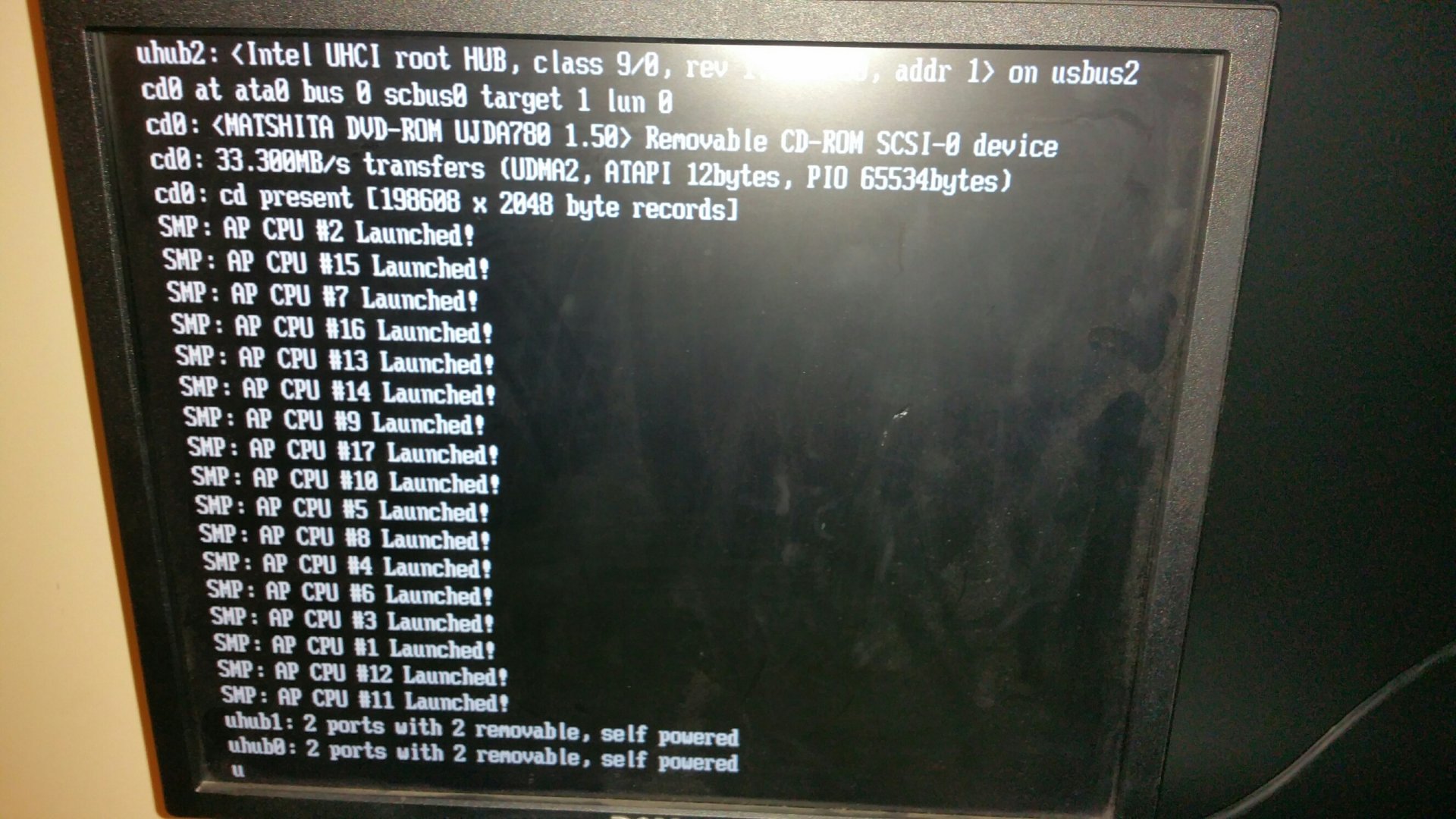

During the boot to the installer the screen hangs every time. Tried messing around with the bios to no avail. Im a noob with freenas, this 2u server was given to me from my company.
SuperMicro X7QCE
4 x Intel Xeon E7420 2.13GHz Quad Core CPU Socket 604
48GB DDR2 ECC REG Memory (DDR2-5300 Fully Buffer) 24x 2GB
ON board Intel® 82575EB Dual-port Gigabit Ethernet Controller
Dual Supermicro PWS-1K01R 1000W Redundant Power Supply Module
1 (x8) PCI-e (using X16 slot), 1 (x8) PCI-e (using x8 slot), 1 (x4) PCI-e (using x8 slot) and 1x 64-bit 133MHz PCI-X

Just updated the bios, still getting the uhub hang. I am installing freenas from the cd, nothing is plugged into the usb. I tried disabling HCI in the USB setting in bios, did not help. Here are some other things I tried,
Different IDE setting
Freebsd(hangs on Uhub also)
disabling all usb setting
enabling, disable raid settings(disabled)

Sounds like he disabled Usb in bios. I tried and it still hangs
tyrone
Feb 16, 2016
5
The problem was the usb. I turned off in bios pre install and turned back on after install.
