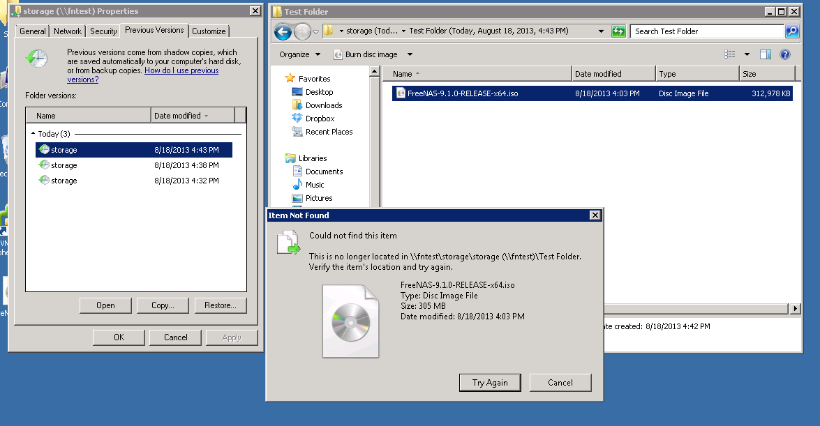

I don't know if I should open a ticket so I'm asking here first:
I have automatic snapshots set up on some datastores I'm sharing out via CIFS. Windows clients see the snapshots fine under Previous Versions. XP SP3 and Win8 can view and access files in the snapshots (whether copying from the open option, using the copy button, or the restore button). Windows 7 clients can open the snapshots through explorer but can't copy files. The copy and restore buttons fail the same way as from the opened snapshot. I have attached a screenshot.
I've searched trac and found similar tickets for older releases, they all reference a changeset that I can't find: r10126. The old tickets:
http://support.freenas.org/ticket/935
http://support.freenas.org/ticket/1186
I saw the problem first on my main box at home. I did a clean install of 9.1 Release in a VM and the same problem occurred. I did some logging (on the server) and can see that smbd did at some point open the file in the snapshot I was trying to copy and then choked on some disk space functions.
Anyone else experiencing this or found a workaround?
  • partial_log.txt

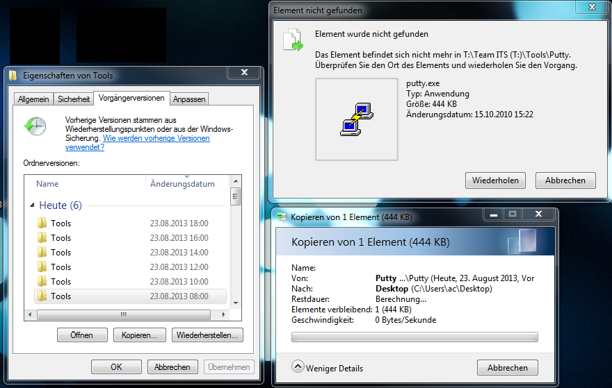

Hi Sakru,
i have the same problem here...
Access via windows explorer's prvious versions to all files an folders works fine. I can open the files from the snapshots but i cant copy them back to the share or to my desktop or anywhere else...
I got the same messages in smbd.log too:
Aug 23 21:44:51 STORAGE01 smbd[52209]: [2013/08/23 21:44:51.417677,  0] smbd/dfree.c:137(sys_disk_free)
Aug 23 21:44:51 STORAGE01 smbd[52209]:  disk_free: sys_fsusage() failed. Error was : No such file or directory
I've attached a screenshot of the windows message...

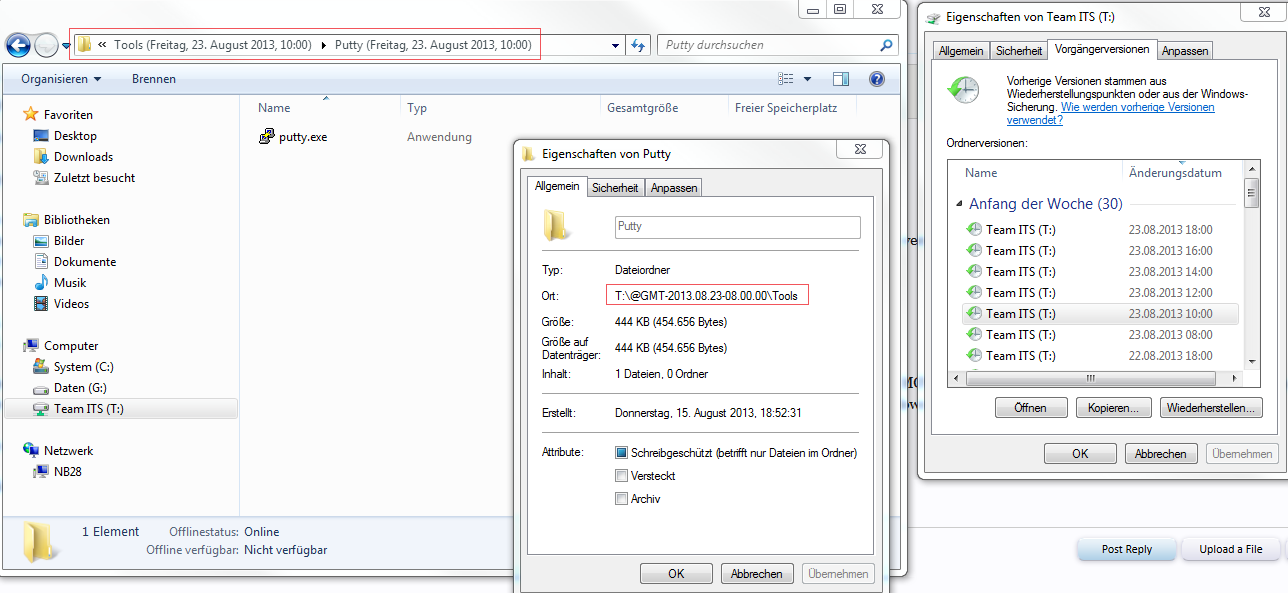

Aug 23, 2013
Hello everyone,
i've played with the issue for a few days an get a few very strange results.
It is not completly impossible to restore a 'previous version' from within windows!
Open up the folder or file you want to restore from the previous version tab in windows an open the properties of the folder/file IN the 'previous version'-Folder
Copy the link to the snapshot (like: T:\@GMT-2013.08.23-08.00.00\Tools)
If you compare this link to what you have in the url-line in your windows explorer you will see the difference:
(see attached screenshot...)
URL in properties of the 'previous folder': T:\@GMT-2013.08.23-08.00.00\Tools
URL in opened 'prevois version' explorer window: T:\Tools (‎Freitag, ‎23. ‎August ‎2013, ‏‎10:00)
If you close the 'previous folder' and open it via the copied link from the previous folders properties from the windows -> run you will be able to MOVE! the previous files back to the share or to your desktop.
I have tried to copy them and had no luck, but the standardoption from the folder had changed from kopie to move since its opened via the windows-run window...
The source file disappears from the snapshot folder but after a screen refresh (F5) is back in its place.

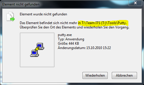

The URL in the error message when i try to copy direct from the previous version folder to my desktop is a very strange too: T:\Team ITS (T:)\Tools (screenshot attached)
There is no @GMT- or something in it...?
Could this be a problem with the service that rewrites the links for windows-explorer or something like that?
smb.conf charset...?
Thats a little bit to much for me :(
