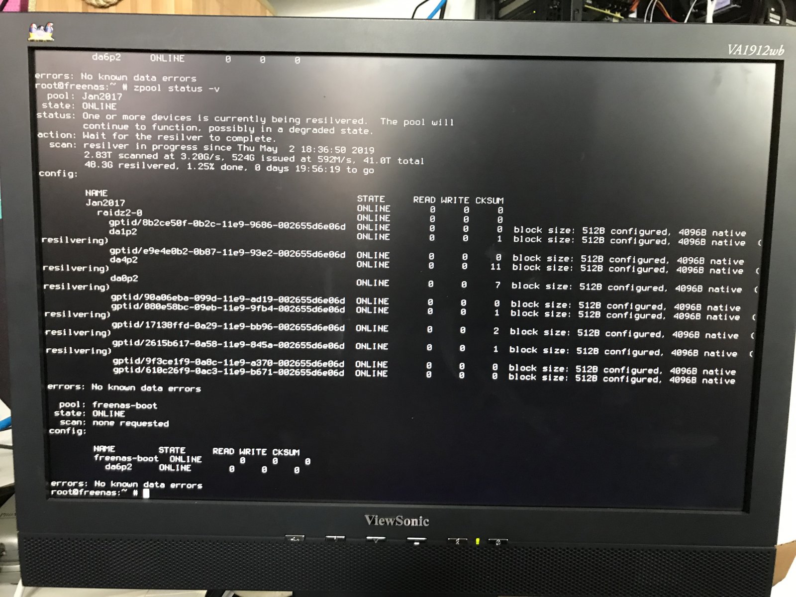

I ordered a LSI SAS Contrroller with an IBM Expander. I read that I could just hook my drives up to them and FreeNAS would see them with no issue. Once I booted up 4 of the 11 drives began resilvering. This went to about 2% and then crashed the computer. I removed the drives from the new controller/expander an put the drives back to the motherboard SATA ports and the Asmedia controller. The thing is I don't remember the exact order that each specific drive went to each specific SATA port (I was under the impression it wasn't supposed to make a difference). Now when booting up- 6 of the 11 drives are resilvering. It crashed arund 1% and that's when I kept it turned off and now I'm writing this post. I just ordered a SuperMicro server motherboard, ECC RAM, and Intel Xeon CPU. I didn't have time to record any info, but I did take the attached picture. Hardware info should be in my signature. I was running 11.2-U3, but that started crashing when I started doing transfers from macOS (for no reason I can explain). I rolled back to 11.1-U5 and it was running stable until I added the SAS/Expander. Please help.

I would disconnect the drives and run memtest. Note that all resilvering drives have checksum errors.

@Chris Moore I don't know what went wrong either, but it got scary for me. I thought I had a backup, but it turns out I didn't. I am now building a 2nd FreeNAS as my backup and I'll be putting that offline in another location to protect from fire/theft/ransomware/etc and so I never have to feel stress like this ever again. I need to make sure I do everything right moving forward from here to give the best chance of not losing a lifetime of data. The previous configuration was using the 6 SATA connections on my motherboard and Asmedia controllers for the other 5 drives. It worked great for many years. I knew I was using non-ECC memory and cheap SATA controllers, so I finally decided to do it right. Moving over to the SAS controller is where all the trouble started. I updated the firmware only on the LSI controller, but not on the IBM expander (I didn't know that was possible) when I did the change and all the problems started. As of now- I have updated the IBM expander as well to the latest - 364a. I know many people said they had lots of problems from not upgrading the expander firmware, so that could fix this alone. Although- I remember moving a drive to the wrong SATA port in the past and then having the FreeNAS do a long resilver as if the drive was foreign to it. It makes me suspect that my build needs to have the drives in a specific port order. Moving forward- I don't want to turn it on until I have all the hardware upgraded and I have a plan in place. I have already received one of the SuperMicro motherboards and I'm waiting on the 2nd one to arrive within a few days. The new cables will be here Friday, so I can begin testing all the new (used) hardware thoroughly before I hook up any of the drives. Do you know if SuperMicro has a diagnostic disk for their motherboards? I really appreciate your input- thank you.
pro lamer
Feb 16, 2018
626
The screenshot you provided suggests it too.
Edit: three of the drives that don't use gptid are affected (but more of the drives may need to be kept in particular order).
There are ways to escape from this but I'm not experienced enough to know whether it's a good moment to do this...
