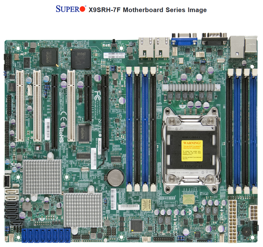

So I'm trying to figure out what I need to add more drives. My motherboard has SAS ports. I'm assuming what I'm looking for is a SAS expander card? The PCI-e looking thing just just uses the PCI bus for power and connects to the MB SAS port.
What's the difference between a SAS expander and an SAS Controller?
I'm eyeballing getting a IBM ServeRAID M1015. That's a SAS Expander right? Do I need the Mini-SAS to Mini-SAS cable and the Mini-SAS to SATA fan out cable to add SATA drives?
Since I have SAS ports on the motherboard, can I just side the Expander/Controller card thing and get away with using one of the Mini-SAS to SATA fan out cables?
The documented map of the MB SAS ports look like SATA ports. Do the Mini-SAS cables connect to those ports?

If your sig is correct the board already has an LSI SAS controller onboard, for the first 8 devices you only need the cables, if you want to use more than 8 devices you need a SAS expander, just make sure the controller is set to IT mode.

SPECS:[Supermicro MBD-X9SRH-7F-O]
so I don't need one of the cards? I can just use one of the fan out cables?

SAS Expander vs Controller - think of it this way, every 4 lanes on a SAS controller (8087 / 8088 / 4x SATA ports) = a wall power-socket. A SAS expander acts as a multi box / power-strip. So you are able to daisy chain expanders together to support as many drives as you want.
In your case (from the hardware listed in you signature);
You have 6 SATA (White and black) and 8 SAS ports (blue SATA connectors) on your motherboard, so you can run 14 drives natively with normal SATA cables.
Running FreeNAS make sure your motherboard SAS controller has been flashed to IT mode
If you need more than the 14 drives, you can add;
1) use 1 or 2 8087 to 4xSATA reverse breakout cables from the blue SAS ports into a SAS expander and then run up to 6 8087 to 4xSATA forward breakout cables to the SATA drives (30 drives)
2) Add a M1015 or similar (IT mode) and 2 8087 to 4xSATA forward breakout cables to the SATA drives (till using the motherboard connectors) (22 drives)

I wrote instructions for this board with links: reverse breakout from the motherboard to expander, then forward breakout from expander to drives (the cables look exactly the same but they are not bidirectional)
