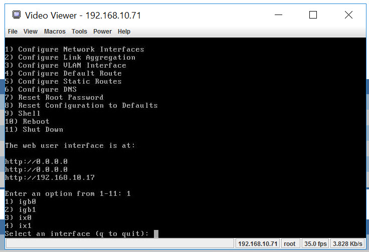

now how do I find out witch card is witch ?
This node have an embedded dual nic igb0 igb1 I thing
an mezzanine card intel I believe dual 10G
and QLogic QLE7342 InfiniBand
1 of those 2 addons is ix0 and ix1

igbN are your embedded ones, ixN are the 10Gb mezzanine ports, and the QLogic card is not being recognized because I don't believe there's a FreeBSD driver for it yet (or it is supported, but it's in HCA/Infiniband mode and isn't supported in that mode)
