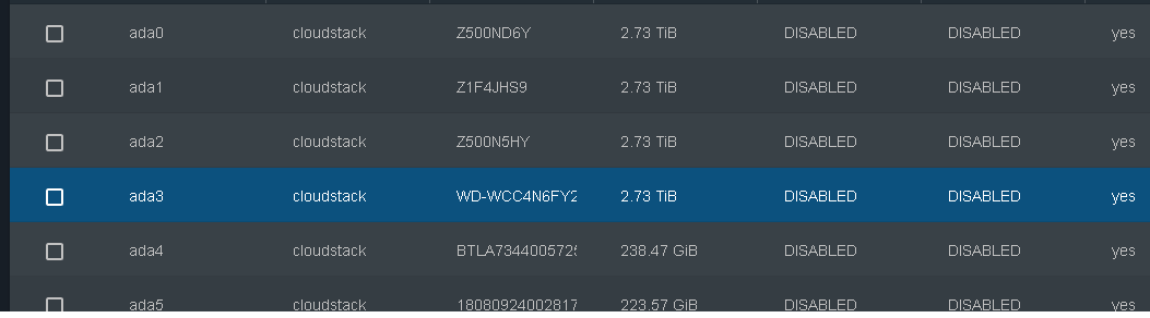

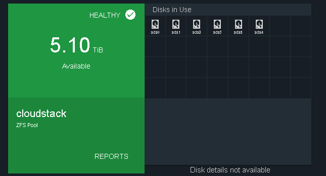

Hi
I just installed Freenas with 4x 3TB disks and 2x 256 for cache but I only see 5TB from the 4x 3TB. is this normal?
Thank you,
Luis

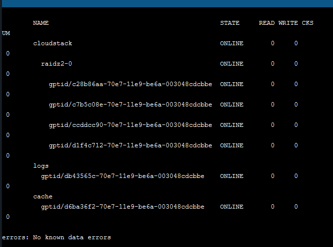

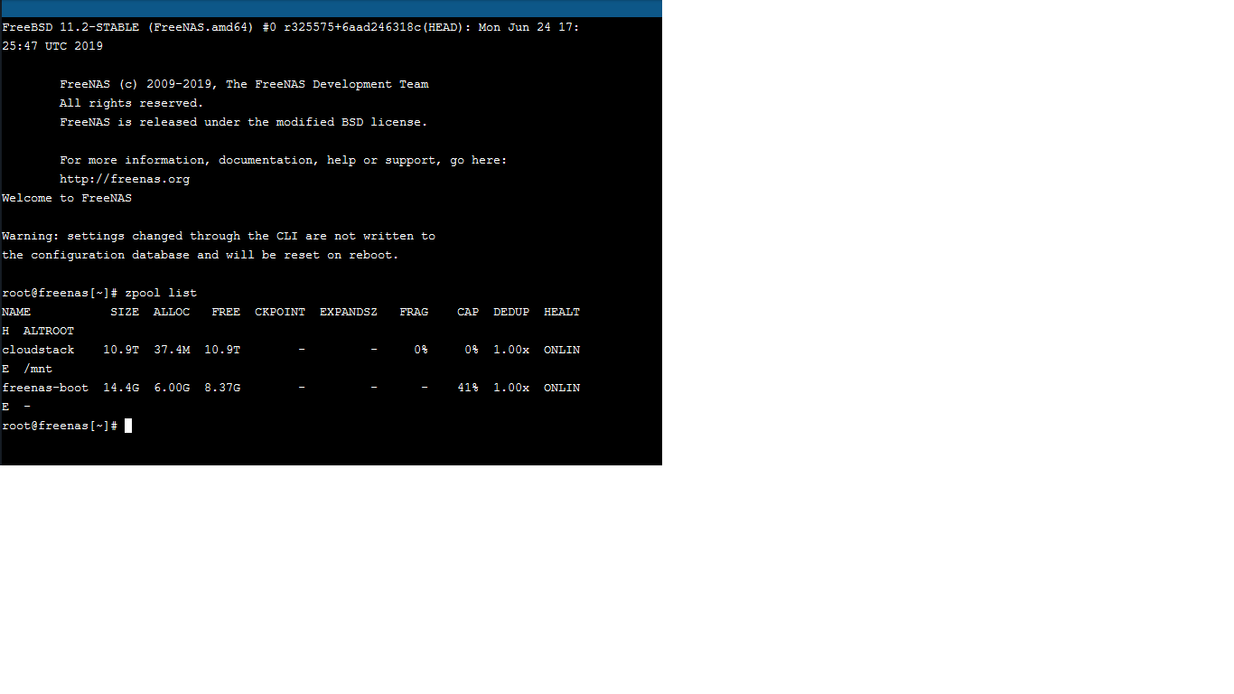

Please post the output of zpool list and zpool status

Here are the results.
Thank you.

Redcoat
Feb 18, 2014
2,922
Well, for your RaidZ2 (2 parity drive) pool that usable capacity looks correct. A couple of things to remember - drives are sold with capacities in TB, we are reporting based on TiB - and we are also seeing the effect of the inclusion of a 20% overhead (above 80% capacity performance is affected, above 95% pool may become impossible to use).
