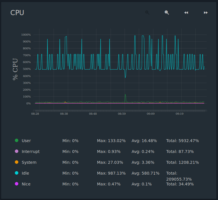

I installed it last night. No issues with the upgrade. Jails, VM's seem to be working okay. Had a play about with the plugins and some seem a bit flakey. Could not install redmine just stuck at 75%. It's not really an issue to me as I prefer to create my own jails and install manually (thanks to the advice of others on this forum). The only other thing of note is the graphs aren't working well - see the attached file. Just for the record I don't see any smoke pouring out the back of the server. This was a pretty good upgrade with no hitches so far.

Things went sort of well. I took the opportunity to move off of boot USB to a SSD. Heard many times that moving the install from one boot media to another was as simple as restoring the config, and while that is mostly true it doesn't restore SSH keys which are required for my remote backup tasks. So just spent some time re-keying everything. If I just did a straight upgrade that likely would have worked perfect.
New UI seems to work better in my chromebook. Old UI required page refreshes to get the pop up windows working again, so thats a win.
I'm also seeing the weird graph not filling in issue but seems to work if I refresh, or at least different ones don't work after a refresh.
My HDD temps seem to be working now, don't think that worked for me before. That's a big deal because I found out I had a fan unplugged and one was rather warm.
