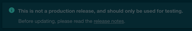

First thing I saw on my 11.2-RC2 test box before doing the upgrade was this:

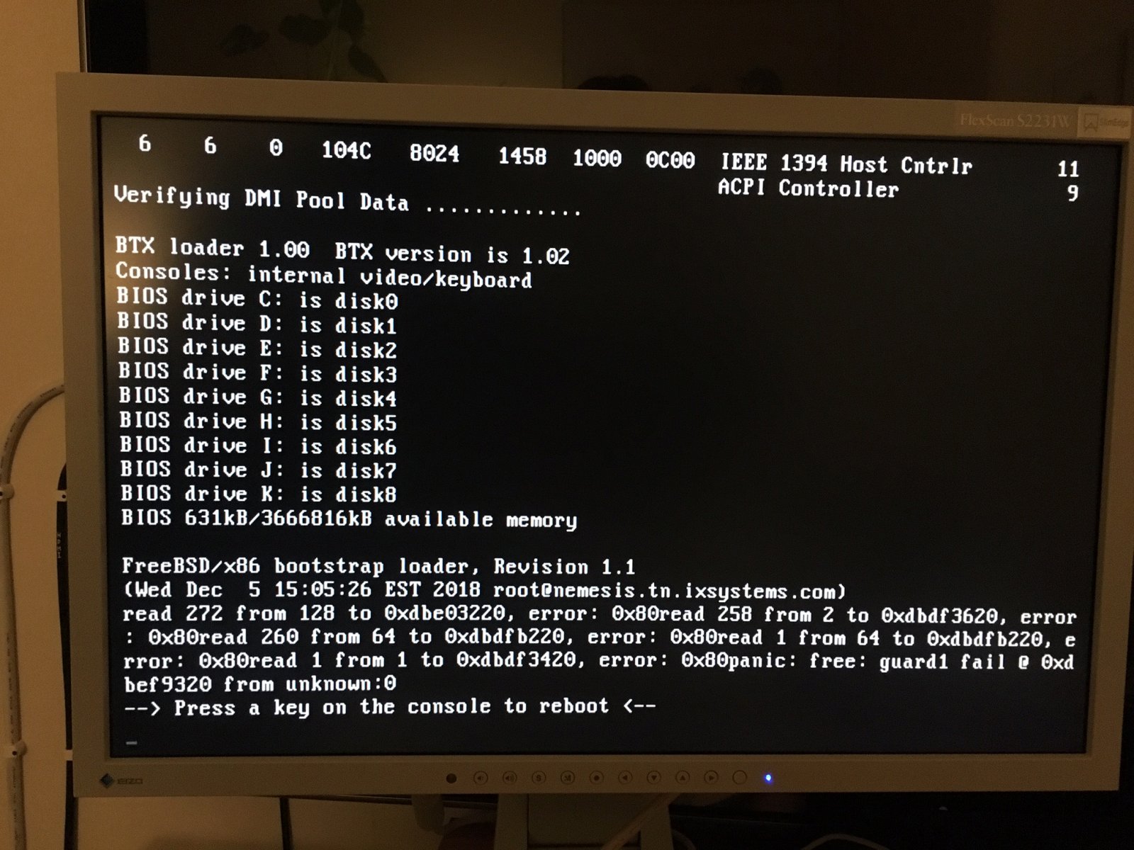

I'm getting some errors while trying to install 11.2 from USB created with Rufus 3.4.1430 on Windows 10 (also tried 3.3.1400 with two different thumb drives).
ISO Checksum is OK
Tried with 11.1-U6 and it worked fine no problem, also Rufus behaves more like it usually do, asks if you want ISO or DD mode and also says "hey i need to download grub, is this ok?". For 11.2 it just grays out everything and just writes it.
FreeBSD/x86 bootstrap loader, Revision 1.1
(Wed Dec 5 15:05:26 EST 2018 root@nemesis.tn.ixsystems.com)
read 272 from 128 to 0xdbe03220, error: 0x80
read 258 from 2 to 0xdbdf3620, error: 0x80
read 260 from 64 to 0xdbe03220, error: 0x80
read 1 from 64 to 0xdvdfb220, error: 0x80
read 1 from 1 to 0xdbdf3420, error: 0x80
panic: free: guard1 fail @ 0xdbef9320 from unknown:0
What am I doing wrong?
