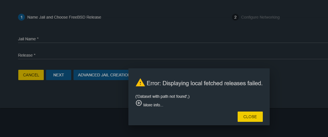

Hello, I encountered an issue related to a new installation of FreeNAS 11.2-U7. I noticed that this is a very similar issue to the case reported here, and while it may not be the same issue exactly, the error message reported was the same that I had. The system was on U3-Beta1 prior to this installation.
I've opened a bug with ixsystems, NAS-104172.
Build:
* 12GB Boot Disk
* 24GB ZFS Mirrored Disks - Jail Storage
* 24GB
* 48TB RAIDZ1
Pools
* Pool1 - 24GB Mirror
* Pool2 - RaidZ1
Context:
Post-install, I was able to import existing storage pools, one was decrypted and the other not with no issues. When I went to activate Pool1 for Jail Storage, no jails are visible. When I SSH into the pool I can see the iocage files are present. With Pool1 still activated for Jail Storage, if I attempt to create a new jail, I get the following error:
2019-11-30 16_44_21-FreeNAS - Error_Displaying local fetched releases failed.png
The full debug is attached rather than pasted here, but the link to the other issue contains the same error code.
