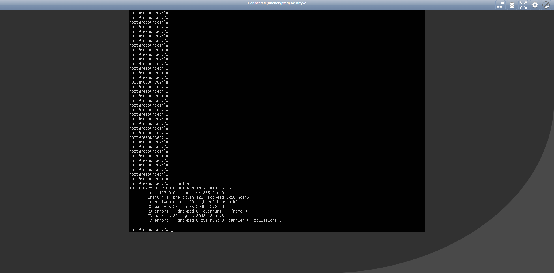

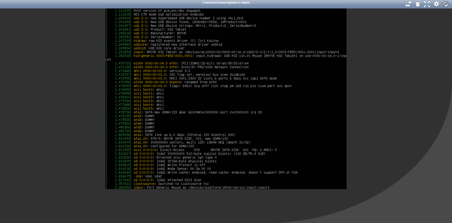

I see only lo

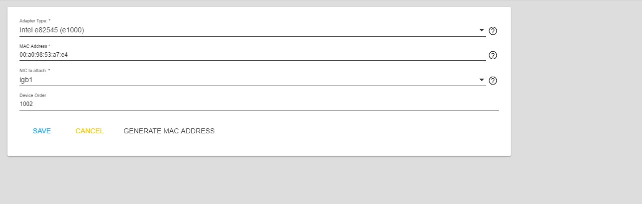

here is the vm config for NIC
yacenty
Apr 30, 2018
54

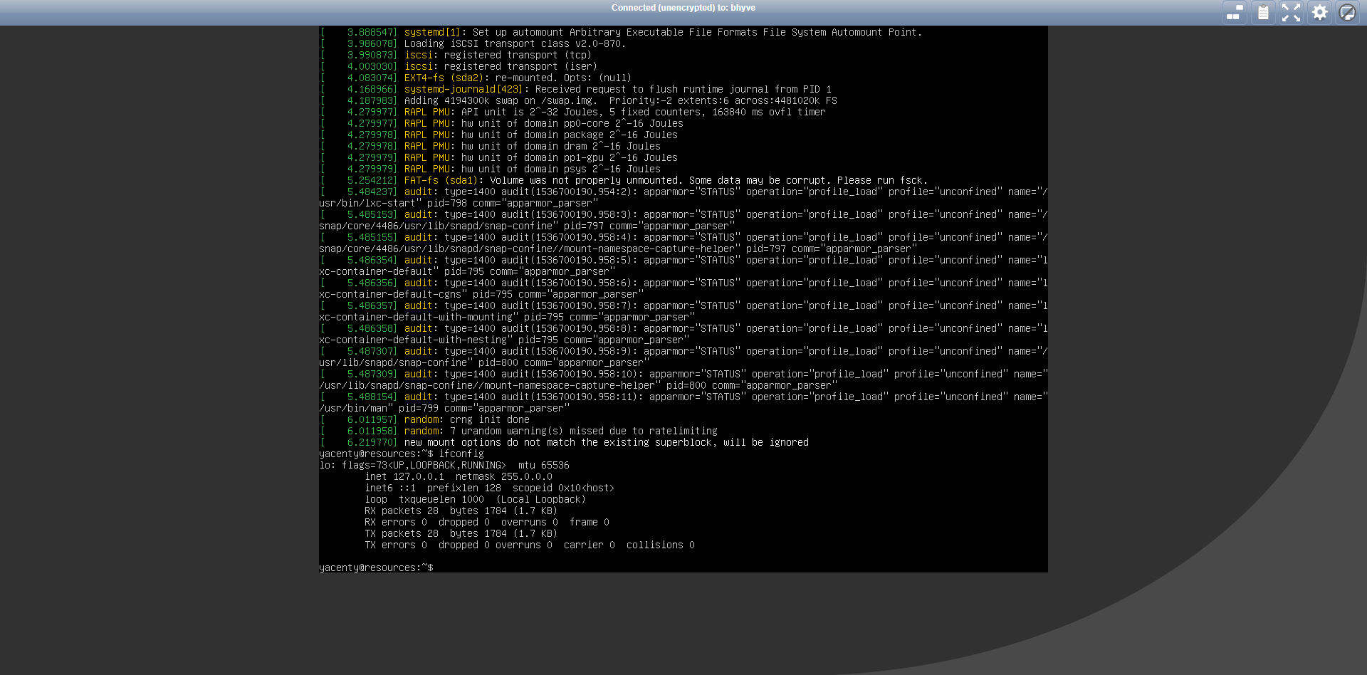

found it in the dmesg
but ifconig shows only lo
how can I add this nettwork card called? enp0s4 or e1000

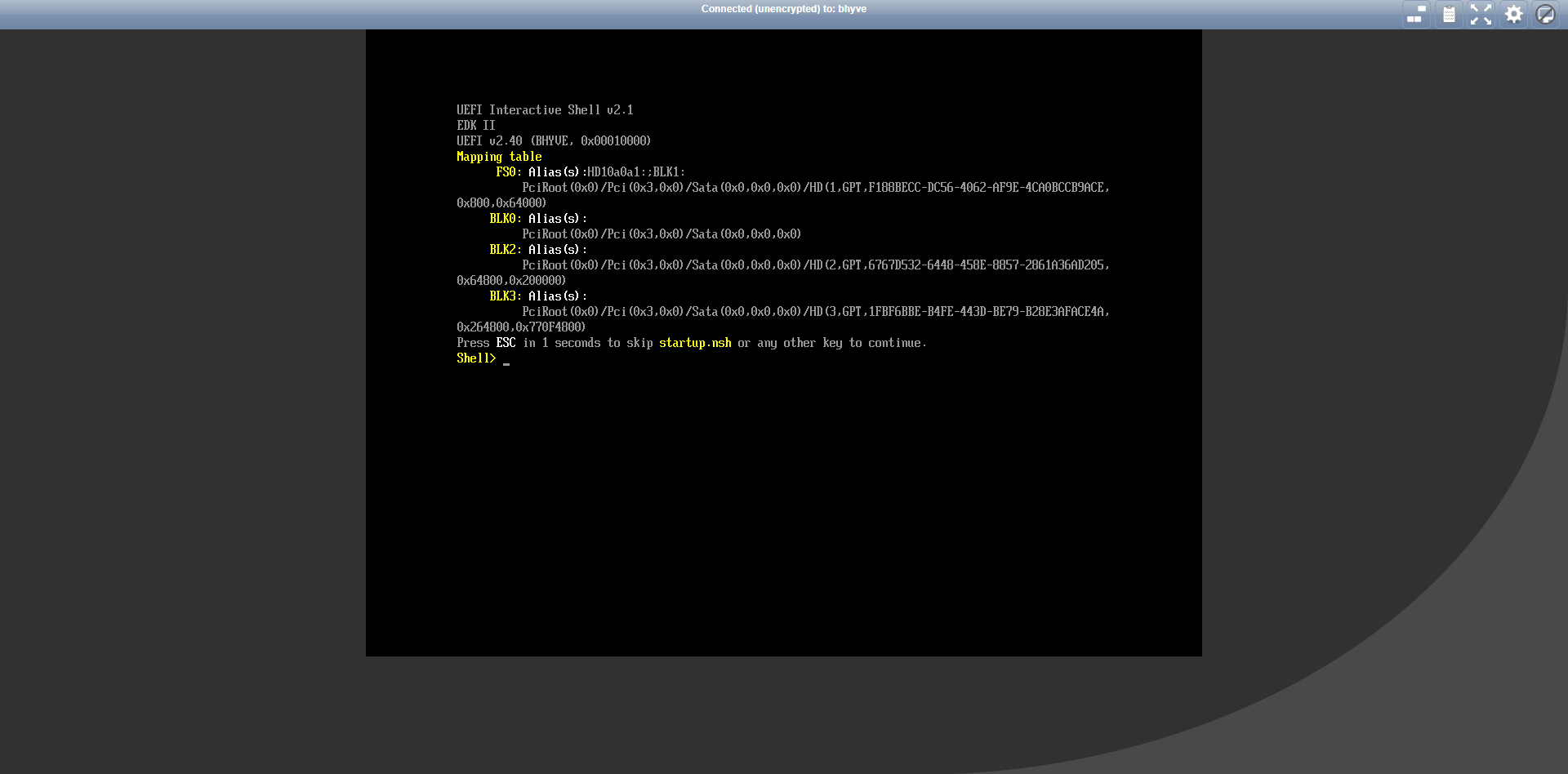

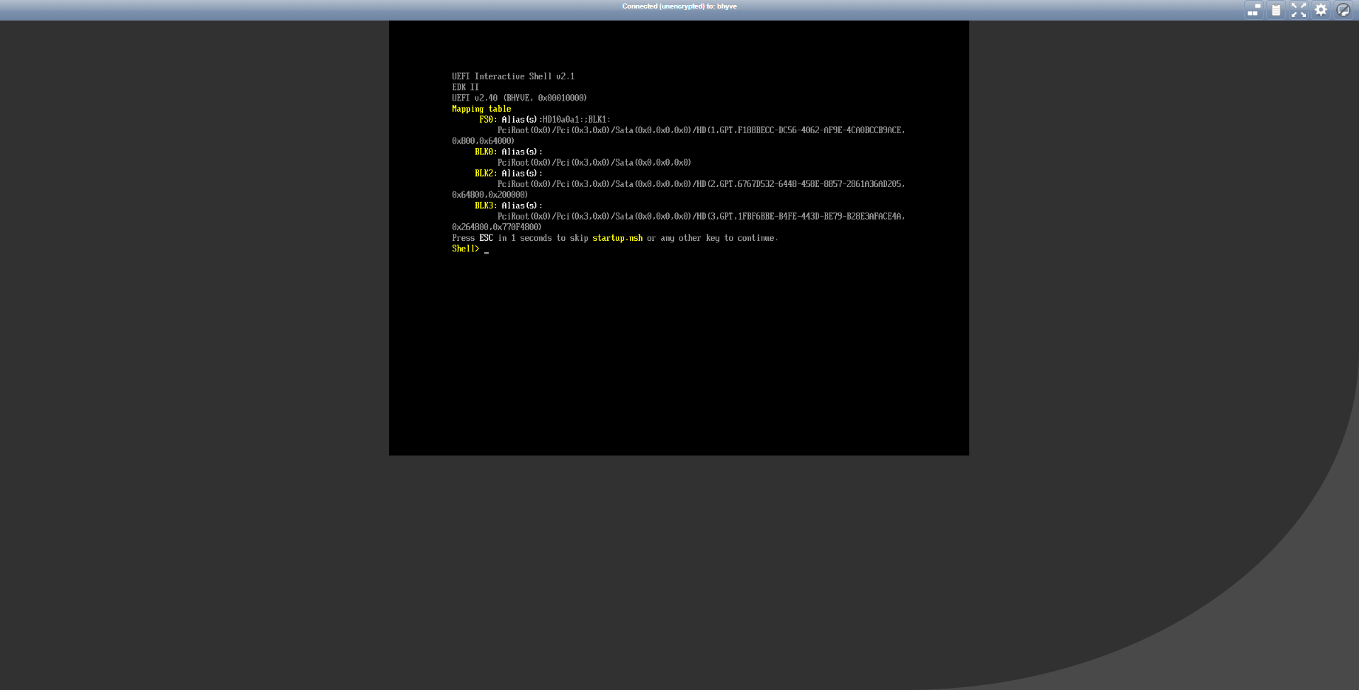

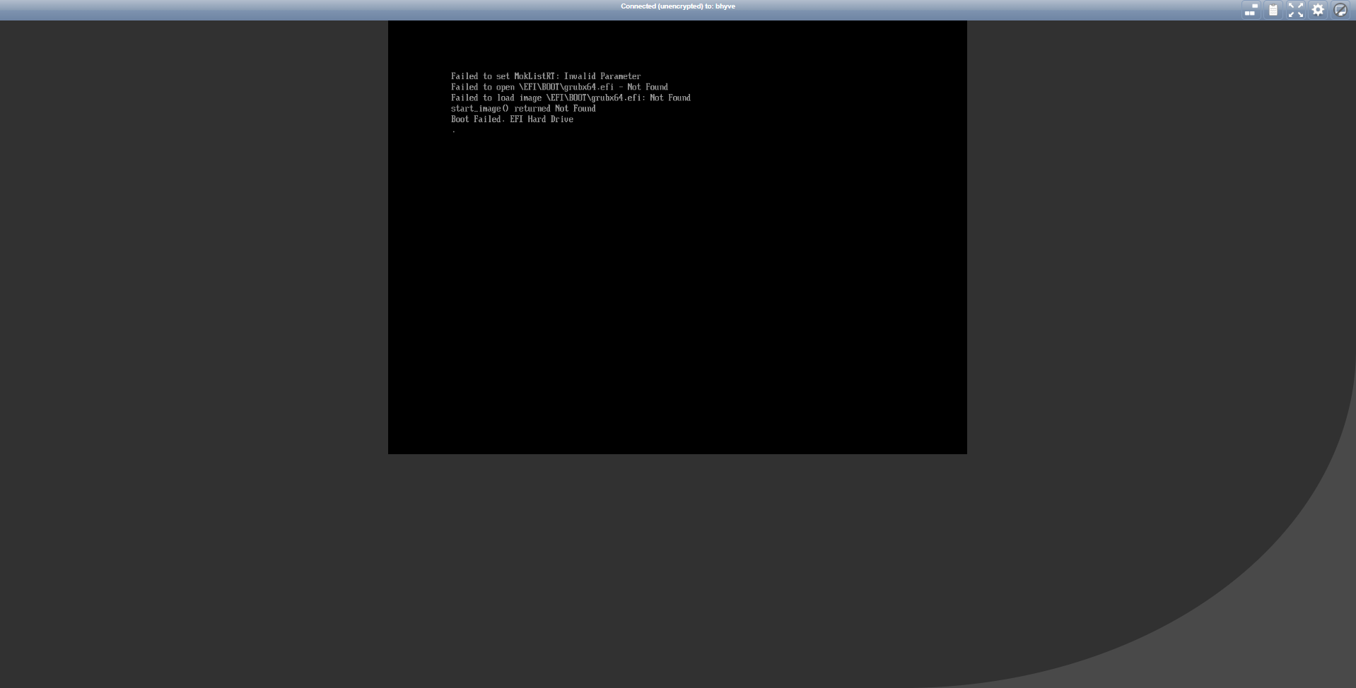

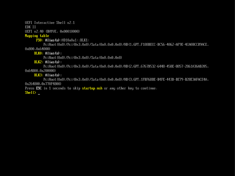

going back to centos problem with uefi boot

interesting is that the device is called "enp0s3" then is renamed to the eth0, and then once more renamed to "enp0s3" - according to the dmesg entries.

Changing the "device order" in the WebUI number would be simpler. Setting it a number lower than the disk device should restore the NIC to its original slot number.

what about the problem with starting Centos VM?
Maybe also changing the order of disk is a problem?
Any idea how to fix?
