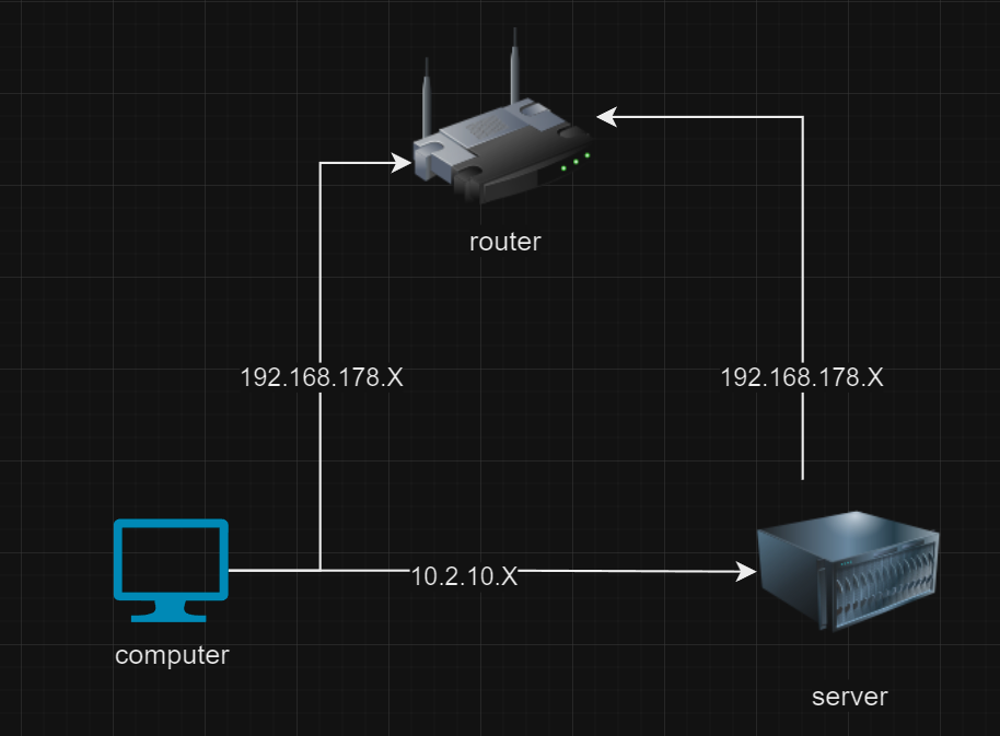

I assume your 1 Gb connection / home network is correctly configured and does not need any change. Remove the 10Gb interface from the bridge.
I also assume your PC is directly connected to your truenas machine via the two 10 Gb cards.

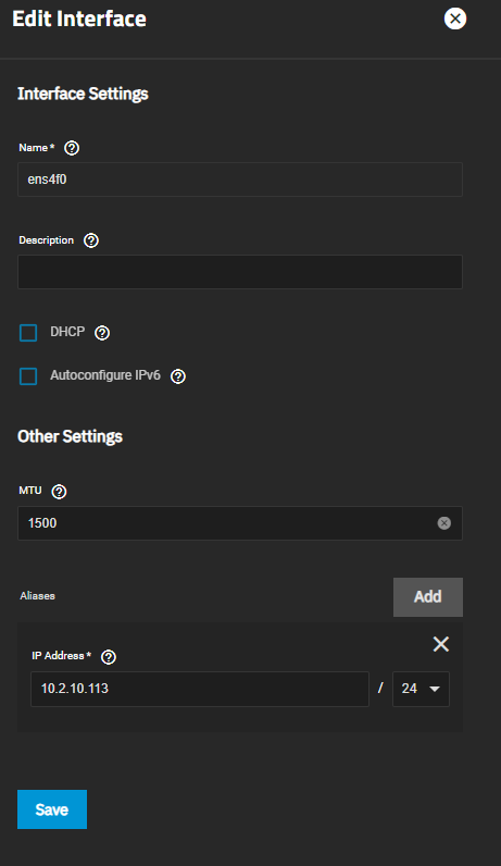

Something like this:
This is my 10Gb interface on truenas:

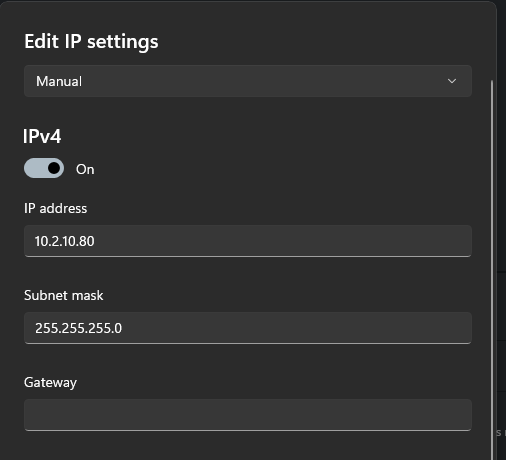

In windows I assigned a static IP in the same subnet:
And then just mount your shares using the same subnet
My local homenetwork lives in the 192.168.X.X space.

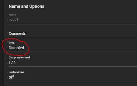

I encountered another problem: Since I only tested 10gb transfer-connections I ran into a problem with the 1gb connection. Write speeds dropped to 0. Read speeds were fine at 120 MBs. So I turned off Sync and write speeds reached also 100. I read that it is not recommended to turn off sync. Is there another possibility to increase speed with sync on? Otherwise I have to give up ZFS cause I need the 1gb shares.

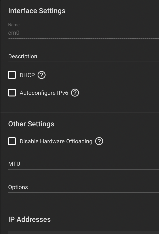

The Network tab where you define your interfaces.

Do you mean MTU? I left it blank so it should be at 1500. 10g is working fine. I have no SSD share. Yes, they are SMR. That are really bad news! Flicked through some posts. Overheating, data-loss... hurray. I guess that was a short trip to ZFS. As new drives are no option I guess I'll have to move to unraid with XFS than...
where did you read that? sync is rarely needed. sync is off by default, and smb cannot interface with sync at all.
you can improve speeds with sync with SLOG, but should be a whole other thread.
the quick version:
SLOG will never be as fast as async, nor is it a cache as is often mistakenly stated. SLOG is a backup of the ARC write cache, and will still slow your write speeds down overall, but be fast then sync to spinners, as all sync writes are written 3 times. once to ARC, once to SLOG/ZIL (ideally this is in parallel to the ARC write), once to the pool.
to get sync with SMB you must turn it on for the dataset shared via smb.
enabling sync without a SLOG means that every write MUST be written to the pool NOW, interrupting anything else the pool is doing to write to the disk in a temporary location, THEN write that again to the correct location in the pool when there are no SYNC writes being requested. with everything as sync writes, you are tanking all writes.
sync is only used for things like databases and VM storage, where any lost write is catastrophic.
