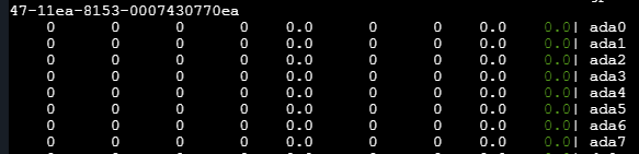

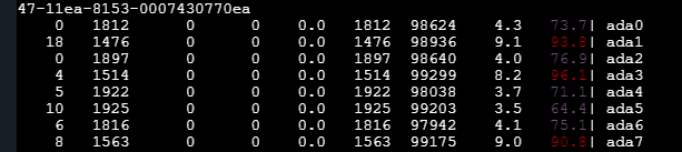

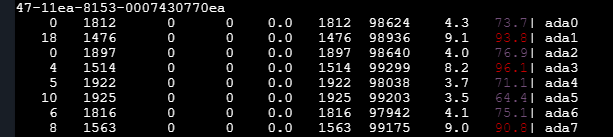

It is a new pool for now. I ran gstat and for the majority of the time they are 0s (screenshot attached). Every now and then the drives to go 1-3.
NO WRITE:
WRITE (70GBs being written to disk pool):
Yep, you're simply hitting the vdev speed limit here. Because you're writing asynchronously, your first bunch of writes can land in RAM, and then it slowly has to taper off until the line speed rate matches how fast your drives can go.
You can band-aid the issue by increasing the dirty data maximum for a longer "burst period" at the start, at the cost of RAM, but the only way to get faster sustained long-term, is to have more vdevs or faster drives.
