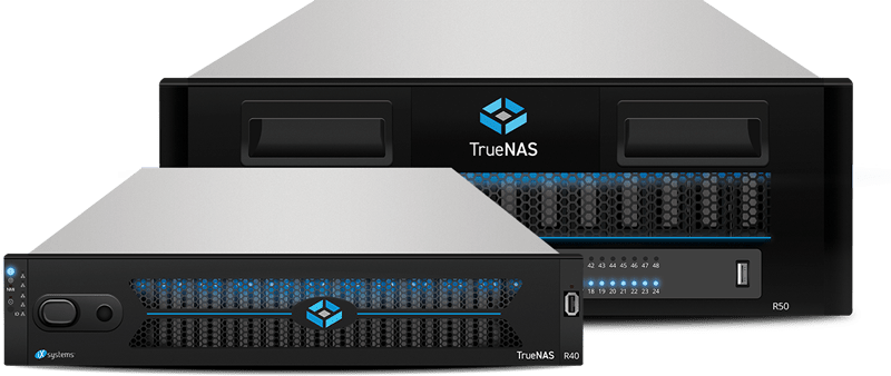

Hello and welcome to the forums,
Are you interested in piecing together a machine yourself, or would you like a turn key solution?
For turnkey solutions, have a look at ixsystems.

You will save a lot of time and effort if you buy a turnkey solution from iXsystems.
You should at least call them for a quote.
A TrueNAS R20 with 18TB disks will do the job and you can even add two expansion shelves if needed.
