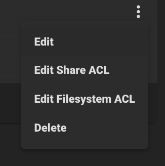

I tried to figure out what the SMB share ACL is all about. So I hit the three little dots next to my SMB share and clicked “Edit Share ACL”. I then edited thing that didn’t work as expected. So I tried several settings. Up to the point where now the panel for editing the ACL doesn’t show up anymore when clicking “Edit Share ACL”. There seems to be a serious bug where some settings prevent you from future edits.
Where can I find the edits the GUI makes, so I delete them to be able to use the GUI again?
UPDATE: actually “Edit Share ACL” doesn’t work anymore for all the SMB shares I have. Is there some log or something to debug this? Or should I reinstall TrueNAS?

I see. getfacl . and getfacl * work flawlessly. At least in the directory I am. What command do I have to use for viewing or resetting the SMB ACL?
Edit Share ACL -> not working
Edit Filesystem ACL -> working

For some reason the almoste identically titled post “Edit Share ACL suddenly stopped working” didn’t show up when I was searching the forum. In this post I found the solution that helped me as well:
Hi again, somehow, a bad SID was causing the ''crash''.
-Disabling SMB service
-Fixing the issue
-Re enabling the service
Seems to work now.
Looks like there's a missing error message in the code
Cheers

Sorry…turns out this only helped with the share that I played around with. The other (untouched) shares still don’t show up the panel to edit the Share ACL. Even when I disable the SMB service. There seems to be something flawed in the GUI/SMB/ACL config.
UPDATE: apparently here the issue was that the other shares where disabled. Instead of not providing the option to “Edit Share ACL” the GUI offers this option without function. In other places in the GUI it disables or doesn’t show invalid options.
