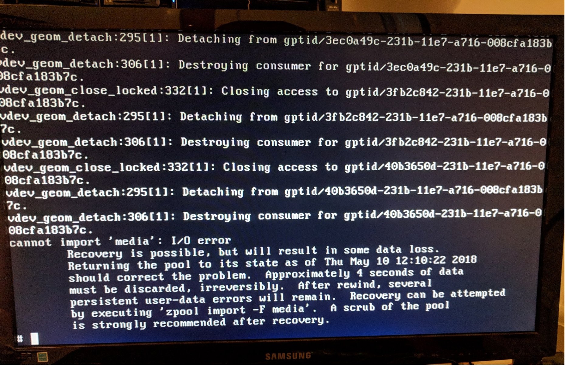

I was able to get the pool imported following the post HERE by @jpaetzel
It seems after setting the follow flags, I was able to stop kernel panic and actually try to recover the pool
set vfs.zfs.recover=1
set vfs.zfs.debug=1
boot -s
Then when I tried zpool import media, I got an error saying Recovery is possible, but I will lose 4 secs of my data (attached screenshot)
Then I tried zpool import -F media but it said pool was last used by a different system and that I should use -f if I want to force mount it.
So then I tried zpool import -Ff media. A bunch of things happened on screen and then I was able to see the pool when I ran zpool status.
So far, everything looks ok so I will try to recover the data and see what happens. I hope this helps others in the future. I will go over the FreeNAS 11 manual in more detail and try to make sure I am using best practices to reduce any more problems down the road.

Make sure you run a scrub as indicated in that warning message.

If you need those flags, I'd say the pool is toast. Cancel the scrub, get your data off (and don't try to zfs send it and rebuild the pool.
Of course, assuming that it won't import normally after this. If it does, then scrub it and work from there.

Thank you for the heads up. I'm too afraid to reboot it. I am currently coping pictures and important documents over. After that, all that is left is Music, Movies and TV shows. I will let it scrub but I don't really plan on keeping this pool alive. Once I have all my data via FTP/SSH, I am going to destroy the pool and re-build it from scratch
