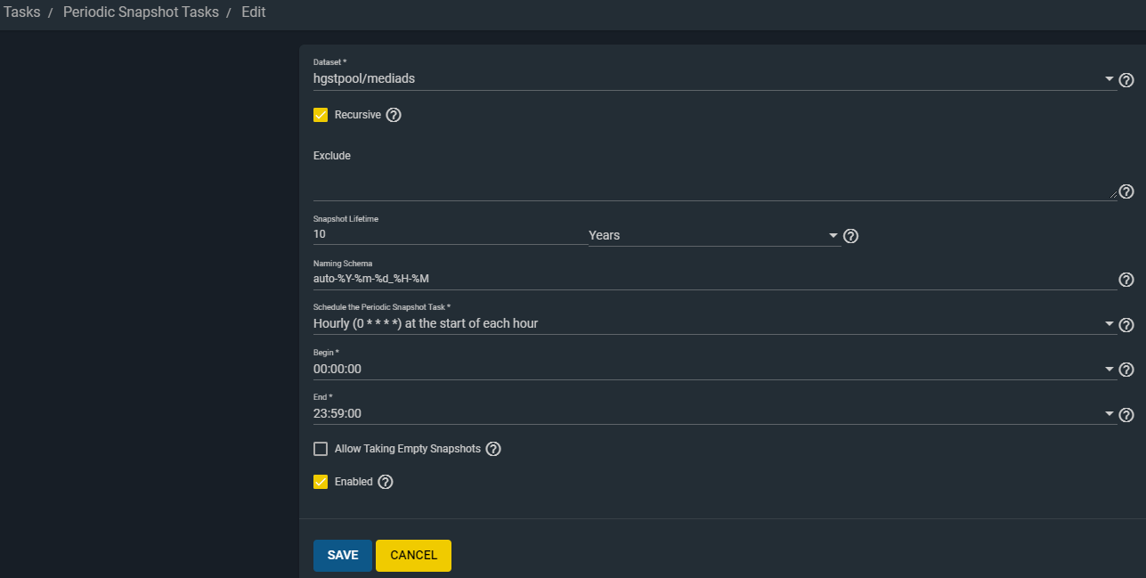

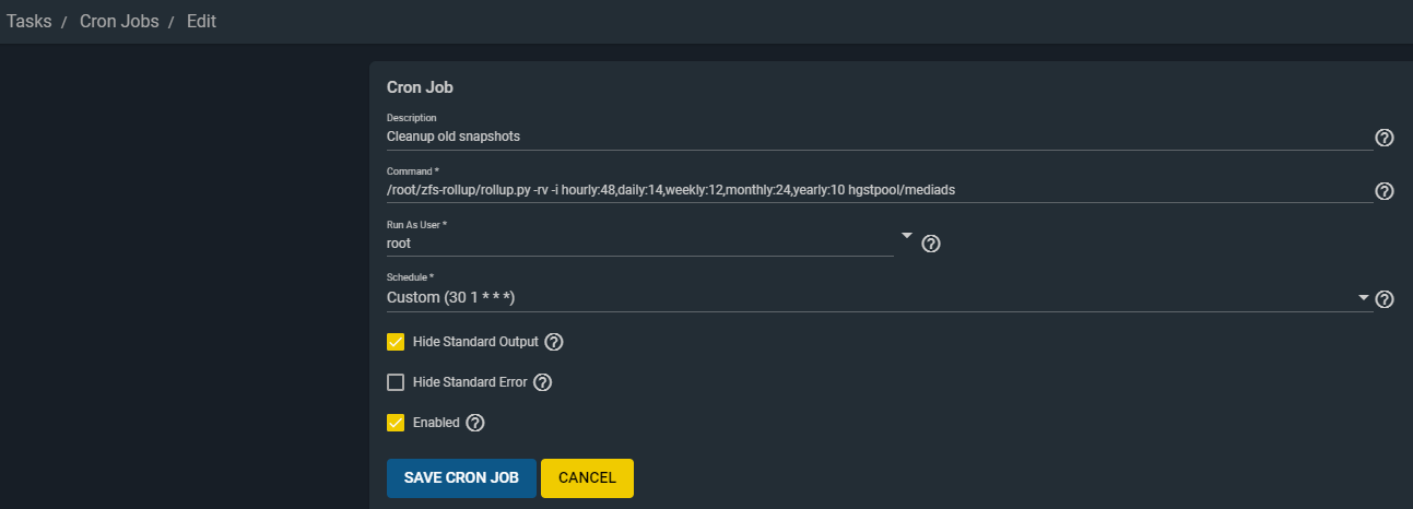

I also struggled a bit with how to use it. I had to make a few assumptions.
To prevent new users from bumping into the same issues, here is an example of what I did:
Please let me know if I made any wrong assumptions or if there are better "practices" to follow, like:
  • Using a non-root user in the wheel group
  • Running it from a jail
root@data[~/zfs-rollup]# mkdir /root/zfs-rollup
root@data[~/zfs-rollup]# vi /root/zfs-rollup/rollup.py
    <copy paste the script in there>
root@data[~/zfs-rollup]# chmod 750 /root/zfs-rollup/rollup.py
root@data[~/zfs-rollup]# ./rollup.py -rv -i hourly:48,daily:14,weekly:12,monthly:24,yearly:10 hgstpool/mediads
    <lots of output>
root@data[~/zfs-rollup]# ./rollup.py -rtv -i hourly:48,daily:14,weekly:12,monthly:24,yearly:10 hgstpool/mediads
