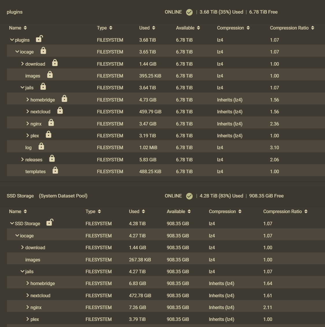

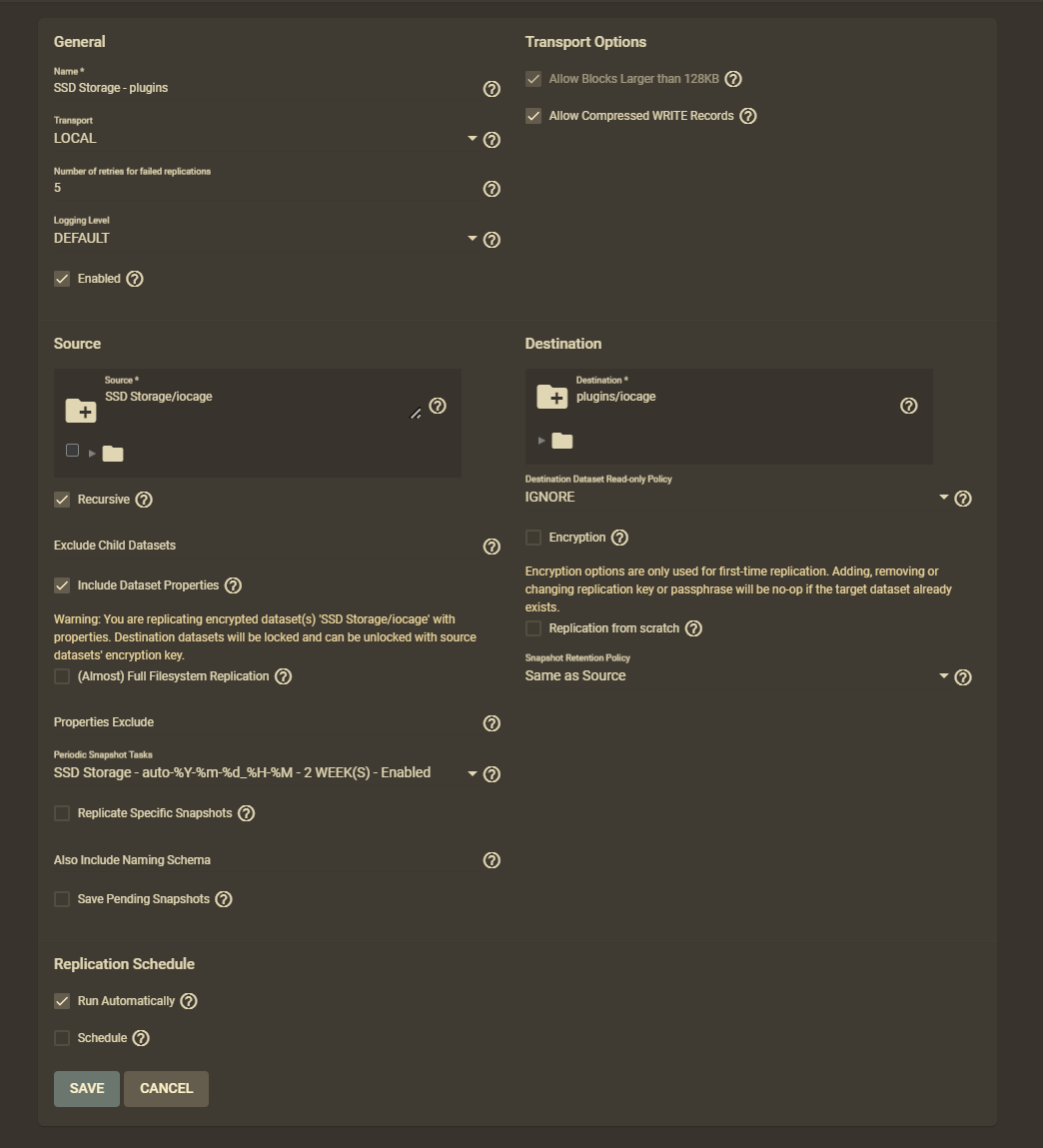

So I am planning to move from one pool to a new pool, obviously moving to the larger pool size. However, my jails folder is not updated even though I have the jails turned off and the task says finished.
Plan was to keep the replication going until I could schedule some time to swap the pools. Its been going for about a week. Went to go confirm the datasets were equal in size (mostly) and found sever gb missing from the new pool.
Included screenshots of the pools, the replication task, and the logs.
not sure if I did something wrong when configuring the replication task or if it only replicates snapshots and this means I have some snapshots missing from my system.

You shouldn't be storing your media files within the plex jail's dataset itself. Use mountpoints instead.
As for the size discrepancy, it could be missing "intermediate" snapshots that are not part of your "@auto_%Y%m%d_%H%M" Periodic Snapshot Task.
Where would these have been created? I don't take manual snapshot and my setup is fairly basic. I can't imagine how these snapshots would have been created if not by my Periodic Snapshot Task.
Oct 22, 2019
3,641
If not manual snapshots, and if not automatic snapshots (using a different naming scheme), then these are possibly snapshots created for your jails from "update" and "upgrade" operations.
You can check either by visiting the Snapshots page or in the command-line using this command:
zfs list -r -t snap -o name,used,refer "SSD Storage"/iocage | grep -v auto
The above command will list all snapshots without "auto" in their name.

Ah, so these snapshots were created when I updating the plugins and that's why only the jails folders are missing the intermediate snapshots.
Okay, so now that I know I have snapshots which have not been replicated, what is right way to remediate this? do snapshots need to be applied in a particular order and so I need to rerun a task or are they atomic and I can just replicate these by tac'n on a command to the above zfs list ... | grep to fill in the blanks in my zfs replication?
Oct 22, 2019
3,641
I commented on a bug report / feature request, because of this counter-intuitive way that TrueNAS's replications operate. They are, by design, not able to handle intermediary snapshots.
That's why I don't use the GUI for my replications (even though I prefer the GUI) because I want my intermediary snapshots to be replicated as well.
Sorry to say, but that's how TrueNAS was designed (and I would argue they won't fix it because of "fear" they might break something.)
If TrueNAS had a GUI for "Syncoid", it would serve as a practical and simplified backup solution, which doesn't require tethering replication tasks to snapshot tasks or "parseable" snapshot names.

    # Required when you don't have any bound periodic snapshot task but
    # want replication task to run automatically on schedule. Otherwise,
    # overrides bound periodic snapshot task schedule.
    # schedule:
    #   minute: "0"
    # How to delete snapshots on target. "source" means "delete snapshots
    # that are no more present on source", more policies documented
    # below
    retention-policy: source
Of course, neither did this fix the difference in directory size between the new pool and old pool for my jails... so now I'm a bit unsure of what the right way to fix this is. There has to be a way to restore these snapshots to the new pool.
Claywd
Dec 25, 2022
8
If the answer is that I need to copy the data using something besides the zfs replication tools outlined here then is it possible to back fill instead of overwriting? I'm using ssds so I don't want to just rewrite almost 4tb of data to the new pool.
Claywd
Dec 25, 2022
8
also, if zettarepl can't handle intermediate snapshots then I suppose I should be using a different tool or replicating datasets to backup pools. Anybody recommend sanoid?
