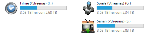

but I noticed today that the size is shrinking when copying new data onto it
I've copied 380GB on a share and all of the shares on this pool decreased by that amount
before they showed somewhat like "2 TB free of 6.8 TB" and now "2 TB free of 6.4 TB"
the shares are mounted on windows 10 only

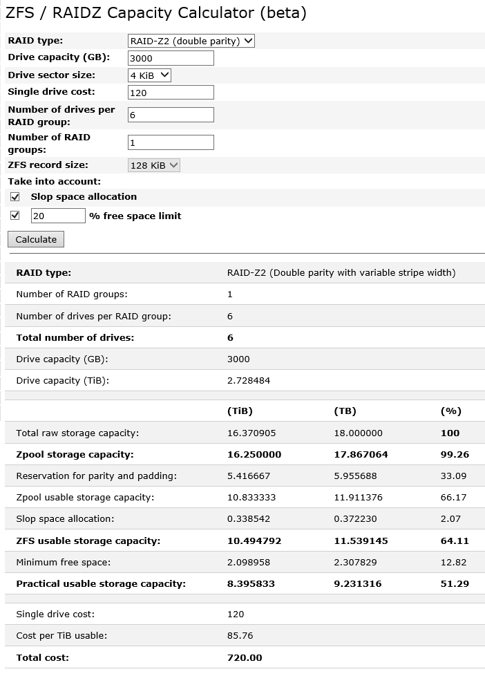

it's a ZFS Z2 Pool with 6x3TB HDD
this should result in 10.494 TiB of useable space
where do I lose another 4 TiB?
4TiB is pretty massive

6.9+3.6= 10.5 why you think you are missing space?

I meant the total size of the SMB shares, of course the free space decreases
but every time I copy new data on the shares the total size decreases as well
you know, this part:
I've just copied 45GB to one share on that dataset
and the total space of all shares decreased:
of course the free space decreased too
but the free space is always the same size on all shares, no differences there

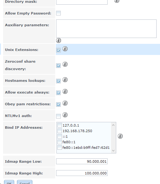

again: my problem is not the pool, it's the shares
why are the shares not showing the actual total space of the dataset?
can this be configured somehow?
is there a flag that can be set?
did I misconfigure something in the smb settings?
or maybe at the share itself?

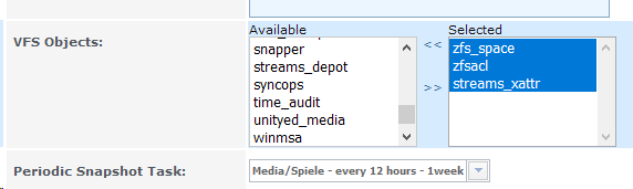

the other two shares have this objects:
this is the snapshot space on that dataset for those three shares:
If all of these shares are mapped to different directories in the same FreeNAS dataset, the info for the dataset is going to be the same for all the shares. You would need to create separate datasets for FreeNAS to report the space separately.

Thanks for your help so far but can somebody answer this?

I may be missing this completely so if so please ignore but I add the below line to my SMB Global Auxiliary parameters to address reported size differences.
allocation roundup size = 4096
