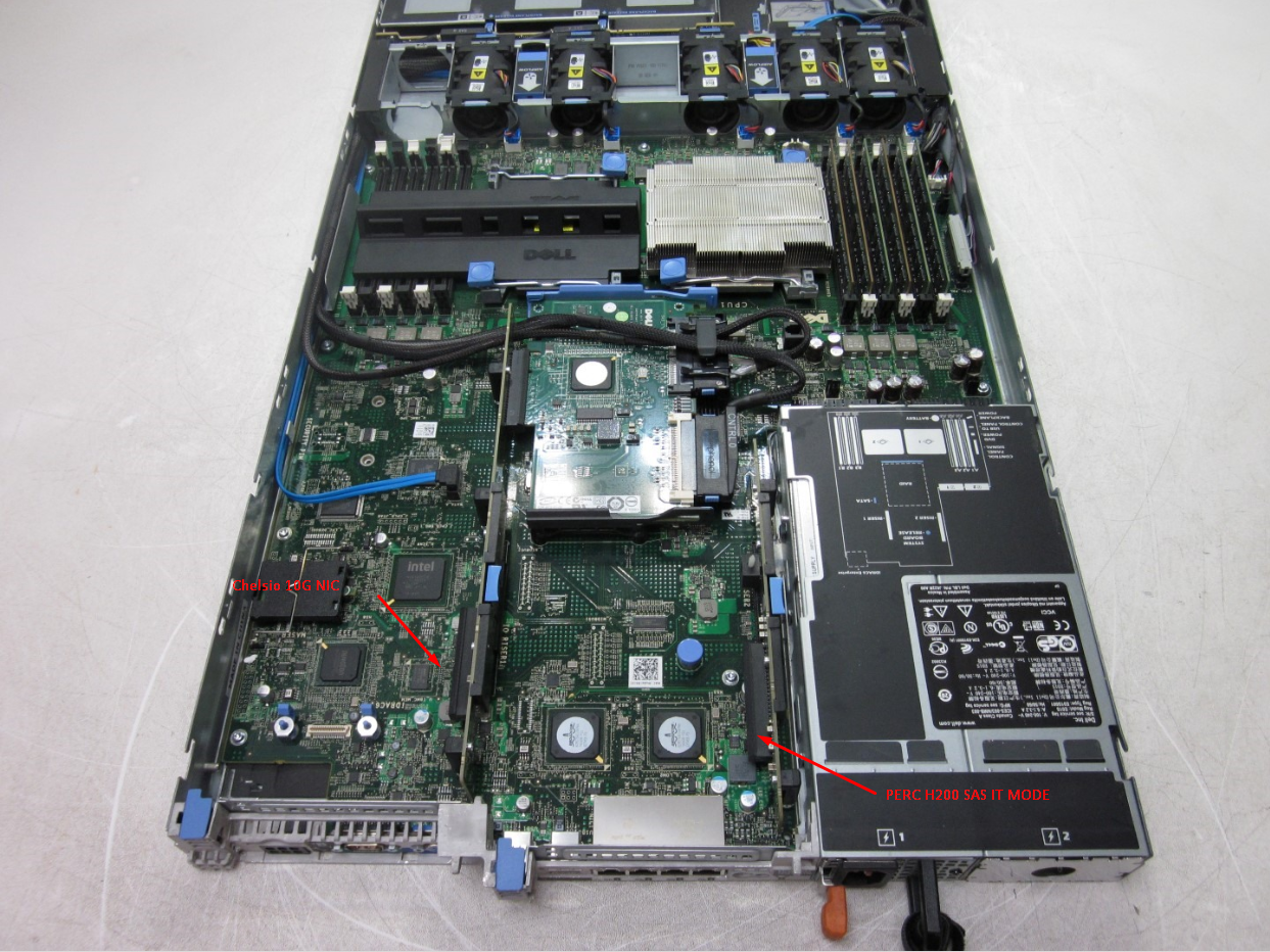

I am building a TrueNAS system with 1x Dell PowerEdge R610 as host. Attached to it are
1x Dell PowerVault MD1200 (12x 3TB LFF HDD)
1x Dell PowerVault MD1220 (24x 1TB SFF HDD)
The storage are connected via daisy chain and the connected to TrueNAS host using a Dell PERC H200 IT mode HBA card.

2. Can you detail the layout of your PCIe cards?
I have 1x Chelsio 10G NIC card connected to 1 PCI Slot and the second PCI slot has the Dell PERC H200 SAS card in IT mode (screenshot bellow)
How are the internal bays connected? I assume you've still got a card in the "Storage" slot (where the PERC 6i is in the picture) - while a hardware RAID card will be acceptable for a boot device (and possibly even L2ARC) I wouldn't use it for anything like SLOG/meta where data integrity is paramount. You might need to look into the "Moving an H200 into the internal storage slot" process I described in my last post.

@HoneyBadger thank you again for the details post. What would you replace the PERC 6i storage card with? I don't think i can connect the H200 to the "storage slot".
I would use a second H200 and convert it to an H200i using the SBR modifications. If you have a PERC 6/i though, you will need to get replacement cables as they're using the older SFF-8484 types on the "card side" and possibly "backplane side" as well.
