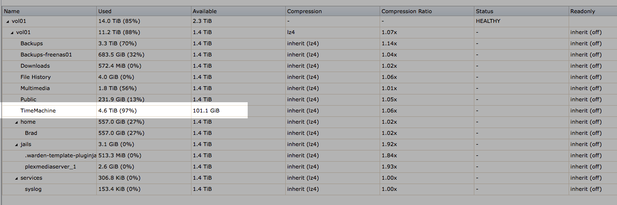

did you have a look at what the webinterface is reporting ?
FreeNAS being an appliance it should be the place we are looking at in the first place.
Maybe you want to check what is listed under the toplevel dataset.
zfs get used,logicalused,usedbysnapshots vol01
Brad T
Nov 23, 2016
15
vol01 stats not all that interesting...
freenas01# zfs get used,logicalused,usedbysnapshots vol01
NAME   PROPERTY		 VALUE	 SOURCE
vol01  used			 11.2T	 -
vol01  logicalused	  12.0T	 -
vol01  usedbysnapshots  0		 -
vol01/TimeMachine is more interesting... but still the same numbers.

Here's what the Storage > volumes web page shows (with a 4.7T limit set for the dataset). Consistent with the numbers reported by ZFS command line:
index.php
I guess my question now comes down to "What other objects consume space on ZFS?"
thanks.... Brad :)

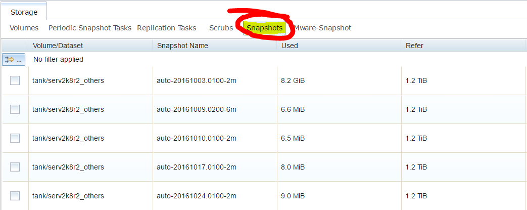

Hey,
well... I'm afraid you are still not looking at the right page in the webinterface ;)
Here is where you really wanna look:
You will then be able to sort by "used" and should see the snapshot/s that are using all the space :D
